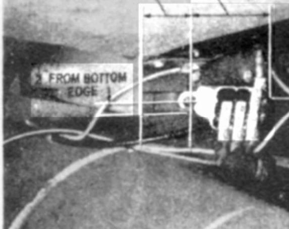

Also, if you look closely at the photo of the OD relay in the workshop manual (in the section about adding OD), the wires appear to run forward from the relay towards the firewall instead of off to the side towards that hole in the tunnel.
