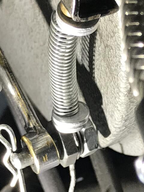

AUSMHLY
A better way is to place small springs, such as those that come in ball point pens, on the cable. This is the cable part that is between the carb mount and cable adjusting nut at the end of the cable. The springs will not increase wear on your carb shaft parts!
Patrick
Right on Patrick! I tried ball point pen springs, and as Bob mentioned, they buckled. Stronger springs are available at your local hardware store. I added a washer to both ends for more contact area. If needed, adding additional washers helps get compression where it works best for the spring you use.
