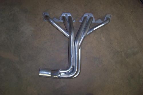

I had this header done with ceramic coating by my local powder coater for about $60 (then decided not to use it). He also did a grey coating on my exhaust manifold.
Looks really nice in the picture; but, looks like it's
gonna drag on the ground. I know, I know, it won't....
it just looks that way.
