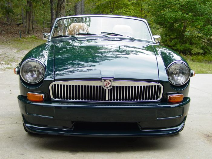

I had looked into the fiberglass replicas that Tom makes,...just beautiful,..I really love the idea of his modified front, which allows for a grill /ubbthreads/images/graemlins/smile.gif
But, my new fenders are notched to accept the original bumper turning lights, and additional bodywork is not in the cards right now /ubbthreads/images/graemlins/nonod.gif

Jerry,
when I changed my 78 to the fiberglass front bumper I had my body man install a set of earlier turn signals into the location where my fenders were notched as yours are. All he had to do was weld in a small piece of metal and drill 2 holes, he charged me 35.00 to do this while he was fitting the bumper.(which fit perfectly BTW with no modifications or extra bodywork) I have attached a picture so you can see where they fit.

OK,..Paul's picture, and advice, have led me back to the bodyshop. I'm going with the fiberglass,...ordered them yesterday,.also ordered the grill and mounting hardware.
The body guys want to smack me,..but heck, I'm spending enough money to change my mind once during the process.:smile:
