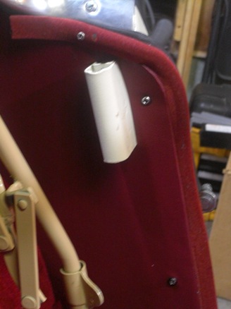

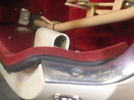

Here are some pics of Martin MacGregor's door seals on my BE. Probably need to take them off at the top and line up the seal better with the vinyl side panel.

Here is another. I cut the rubber seal to provide clearance at the strike. I used the original location of the trim screw which holds it on at the top.
