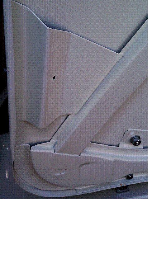

All,
Looking to fabricate the bracket that links the boot lid support strut to the boot lid. (Image attached.) I require dimensions...
Also, does anyone have information to identify the proper style rivets that secure the rear shroud lower flanges?

Pretty sad that out of 57 viewers, I am the one to reply to my query...
So I will modify said request:
Can anyone fire me an image of the attachment bracket/hardware that links the support strut to the boot?
