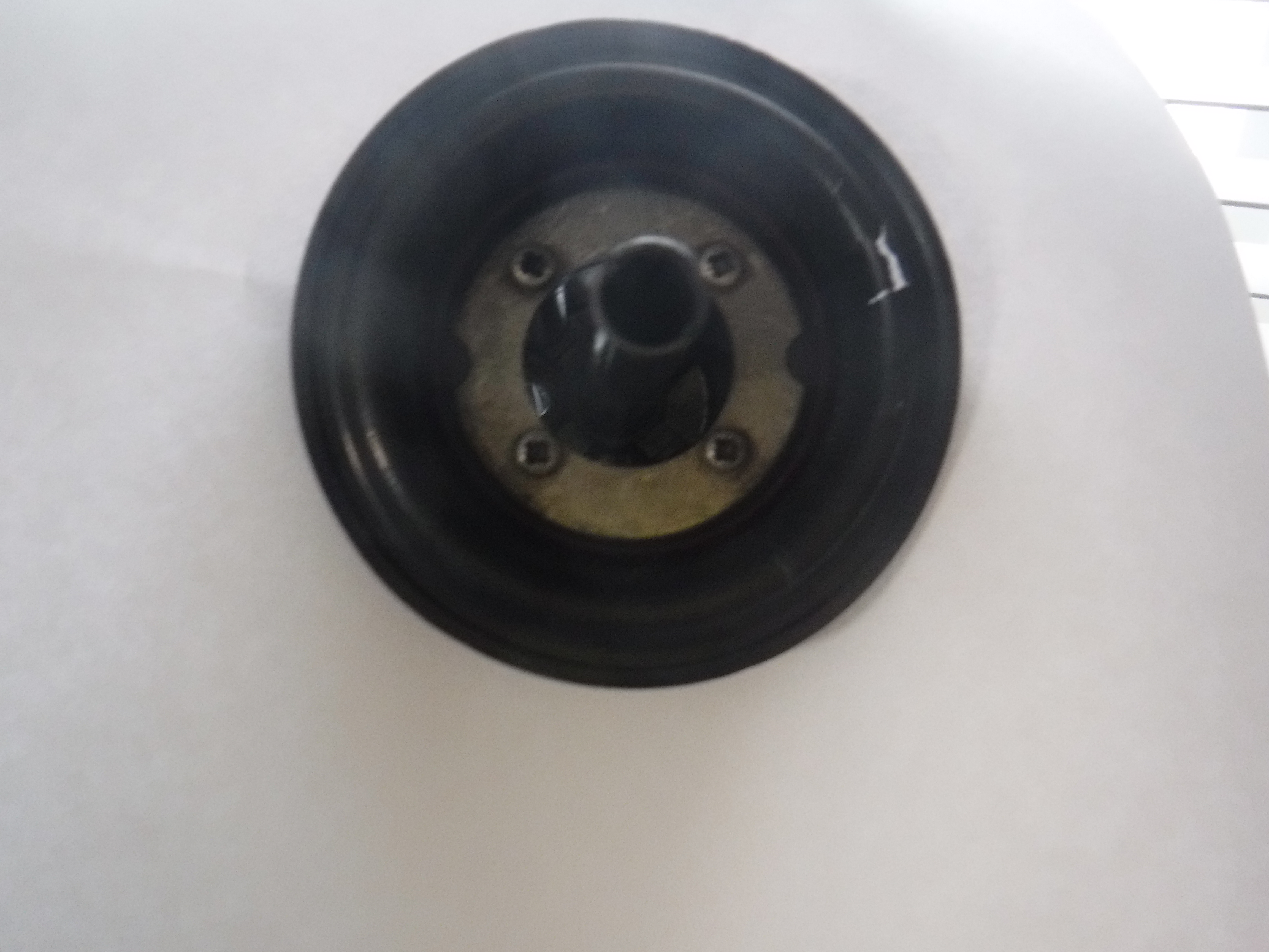

You have CD 175 carbs pull the top of the carbs off your diaphragm may have gone bad and have a hole they only last a few years with todays gas. I carry two and change as needed or on all tune ups. Check carefully and they have a key notch and only go one way. It happened to me just as you said now I always have a set.
Madflyer
Madflyer
Pic this was mine this year

Never thought of that. These carbs have been untouched for years. Never had any problem. Will check the diaphragms in the am. I recall they only go one way. Wouldn't that affect low rpm too? SUs didn't have them.
