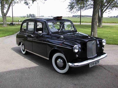

When looking for parts for my 1967 London Taxi Cab, I have a couple of sources.
Kip Motors in Dallas, TX is a great resource and are very helpful with questions and advice.
https://www.kipmotor.com
My other source is Mel Smith at Vintage Taxi Spares in the UK
https://www.vintagetaxispares.com
Between the two companies I have found everything I needed to restore my cab
