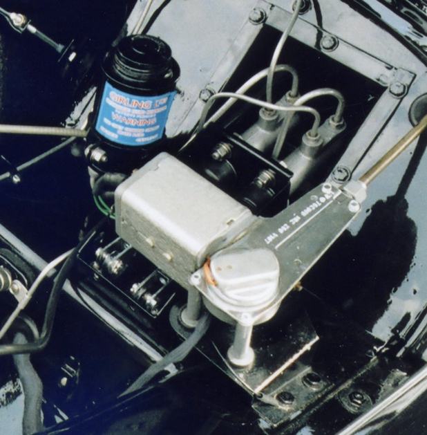

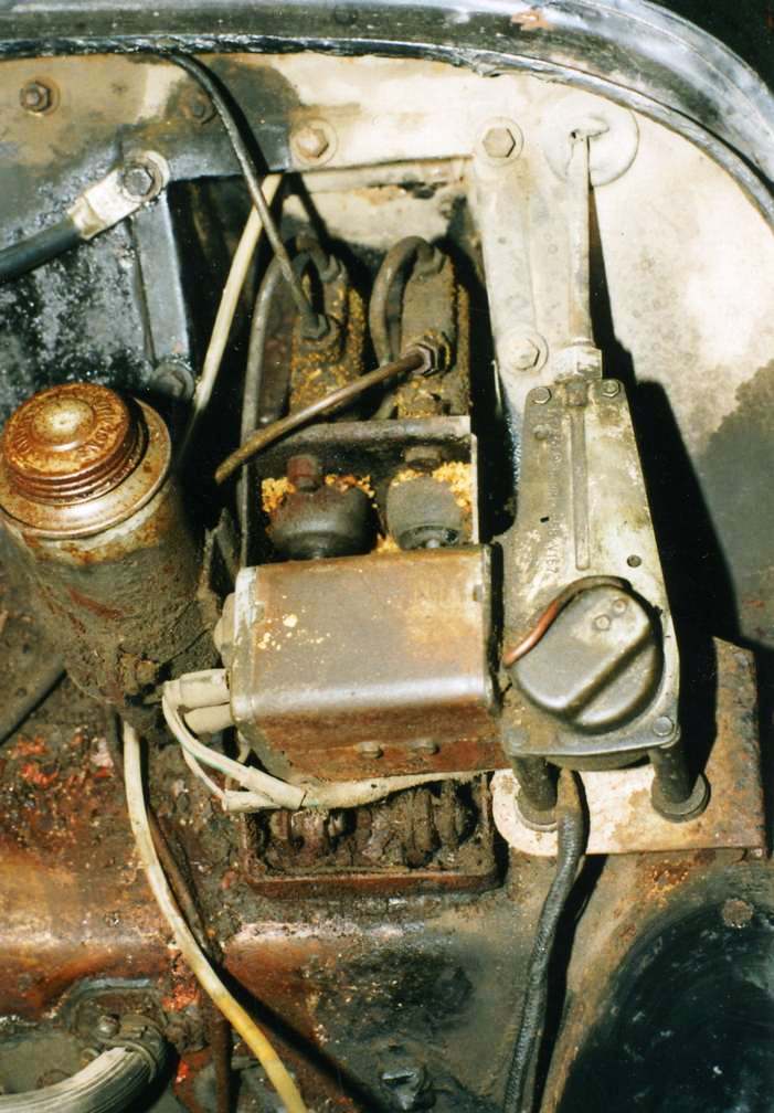

Don Elliott
Notice in the phot above how the pipes all come out straight up. This was like this on the later TR2s all the TR3s and some of the early TR3As like mine. Later, S-T put on master cylinders that were superceded by a new design where one of the two pipes comes out on an angle. It was about 1962 that I had to buy a new M/C from S-T and I got one that was inclined. I lost pints at judged concours events because one (the inclined one) was wrong.
See how mine looked from 1965 or so till I restored my TR3A from 1987 to 1990. Since then, I've driven 102,000 miles and kept it all very clean compared to before when it had 80,300 miles from new.
And those are all the same original parts except for the clutch M/C.

Don Elliott
I just had another look at my two photos above and I think I see why my wiper blades don't come to the spot position as they should. I think I'll rotate the round top cap half a turn so that the orange wire comes out at the 1 o'clock position as it was before I took it apart in 1987.
martx-5
Interesting about the wipers. When I set up mine, the best spot turned out pretty close to the one o'clock position...probably closer to twelve-thirty. Initially, it was almost right at twelve, but once I put the wiper blades on and had some added friction, I had to move it closer to one. :smile:
