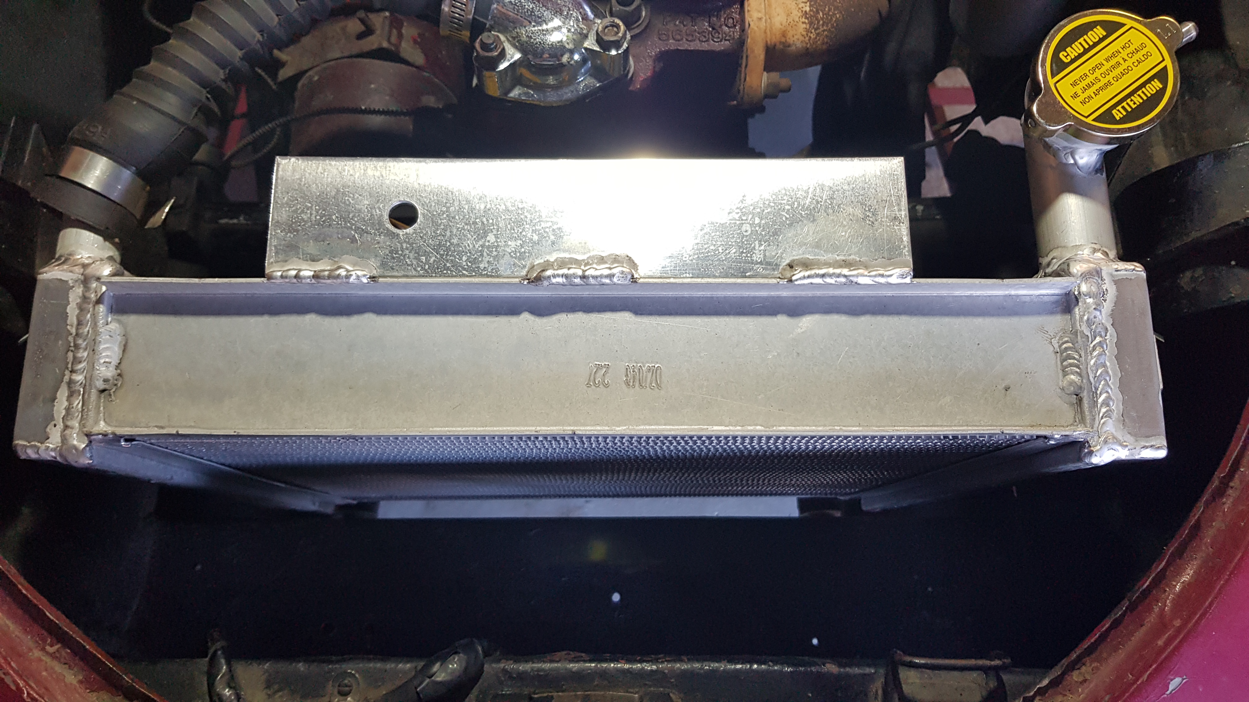

That company has 2x different radiators that they say are suitable for MGA. (although only one fits)
The crossflow unit has the mounting hole positions in the correct position (but doesn't look as nice as the other one where the holes are close together). (being crossflow it doesn't have a top tank)
The crossflow unit still needs to be 'made to fit'. i.e. remove the nipple on the steering rack and replace with a flat hex. Spacers will need to be used to make sure that the radiator is the correct distance from the fan etc as the mounting bracket fin is not in the same place as the original ie. it runs down the centre and the bonnet support hole needs to be opened up a bit.
Other than that it fits.

Hi Simmo
No, I was referring to Worley... the company in Hoppers Crossing. I expect the radiator that you have is not the crossflow one which 'can' fit (the picture I posted is the crossflow in my car). Even though you've ordered a Moss unit...it 'may' be worthwhile asking them to swap for a crossflow unit and have that as a spare? Worth giving them a call I would expect.

Sorry I should have said ...even though you have ordered a Moss unit, it may be worthwhile contacting Worley to see if they will swap what you have for a crossflow unit as a spare rather than sinking the cost. As mentioned, the crossflow unit can be made to fit.
Otherwise what you received I suspect is for some A-Series powered car... just a guess.
