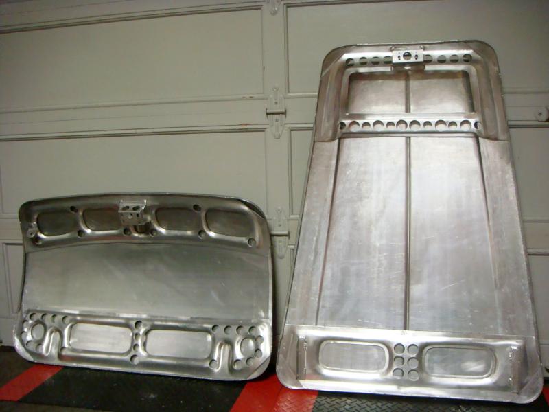

I replaced the bonnet and boot lid with aluminum parts a fews years back. This was primarily for weight savings on my '57 100-6 MM vintage racer.
They were sourced through https://www.ahead4healeys.co.uk/OUTER-BODY-PANELS--OP--ct184.aspx and fit well with very little adjustments. This supplier was very accommodating with my request for special details and additional lightening eliminates. In short, my parts were made to order and I was very pleased with the results.
