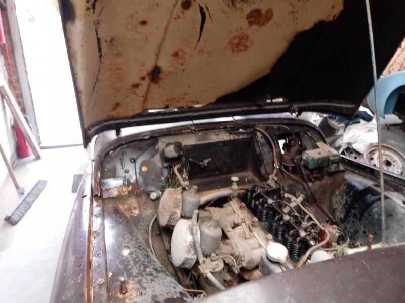

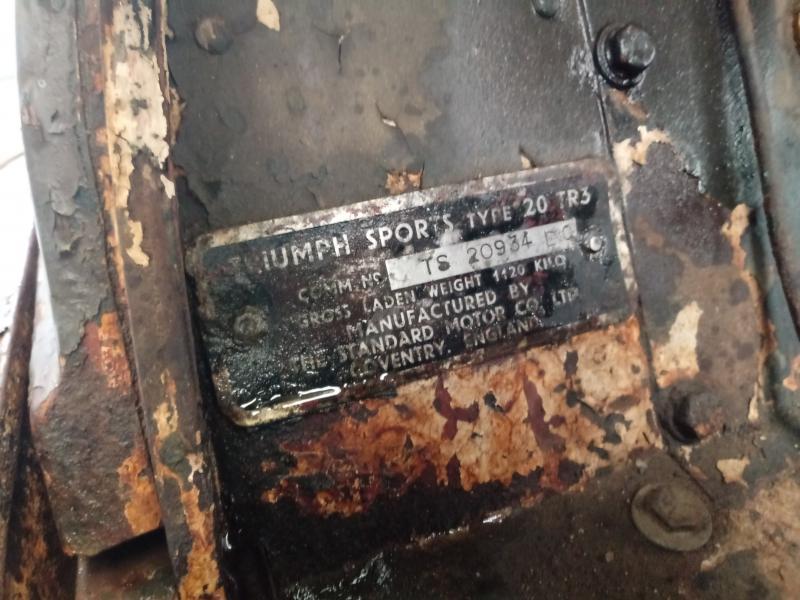

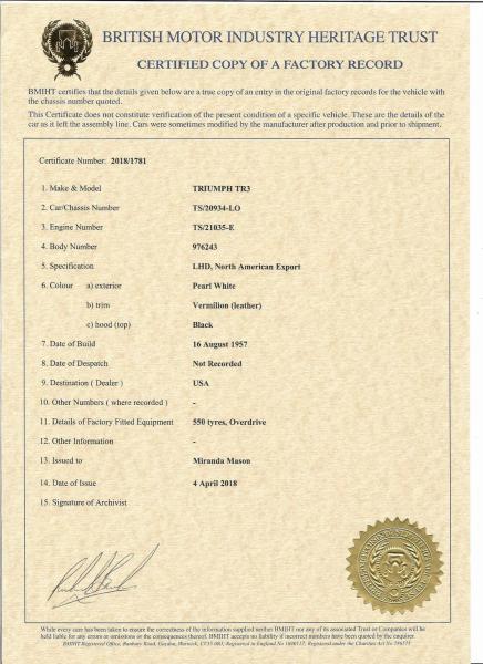

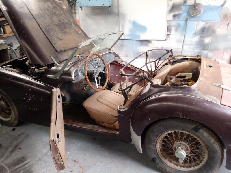

Hello , im a about to start a full restoration of a recently purchased TR2 or TR3 , im not quite upto speed with it all just yet , Reading a few of the threads , it surgests with having a large speaker hole in the right hand side inner wing that is is a TR2 , also has a small mouth but the rear light pintles surgest a TR3 as dose the heritage certificate
Any info apperciated

Alfred E. Neuman
Heritage certificate is almost certainly correct, as long as the ID plate hasn't been swapped to a different body at some point.
The TR3 had the full chrome surround on the mouth, as your car has. Is there a TR2 type grill at the back of the mouth, or is it just missing the grill completely? There's very little difference between an early TR3 and a late TR2.

Also, the early TR3's also had the speaker hole too, so that is not really a designator of a 2/3. Be sure to post pics as you go! It looks like a very nice car to start with.

Even early 3As had the speaker hole; TS39781LO had it.

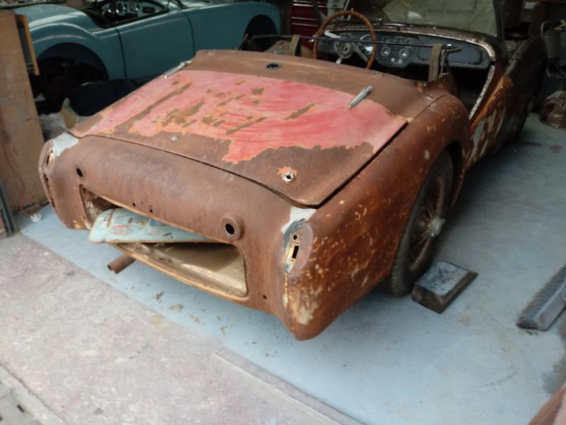

The integral plinths for the separate turn signals in the rear suggest it's a fairly late TR3. The lamps themselves were phased in over some time (partially depending on destination market), but the earliest cars used separate plinths mounted to the early style rear apron.
Best I can tell, that's also the "short" commission plate, which also suggests late TR3 or early TR3A.
Of course, after all these years, almost anything could have happened. I looked at a car once that was actually the front of an early 3A welded to the back of a later (post-TS60000) 3A! The seller admitted it when I asked, but hadn't mentioned it before that.

As the others have suggested, you do have to be careful using "features" to determine the model (TR2, TR3, TR3A), as when there were model changes, there was some overlap. The commission (TS00000) number is the key, unless as mentioned, some nefarious previous owner has messed with the plate. Bill Piggott's book, "Original Triumph TR2/3/3A" is the bible to all the models and changes, but it's not 100% accurate. What inaccuracies there are I consider minor and a result of later, more complete research. The book was published in 1998, thus out of print, but used copies can be found on the internet. Don't pay too high a price for it, though. I got my copy on eBay, and it was originally belong to the Warwickshire County library!
Part of the problem is that Triumph was not adverse to saving (and thus making) a dollar/pound, so sometimes inventory was used up over a change point in production, confusing the issue for us owners 60 plus years later. So a late TR2 would share many items with an early TR3, sometimes months past the supposed change.

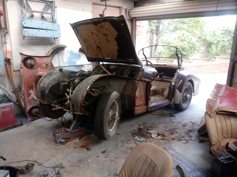

Hi
The TR was a US import , matching numbers car ,looks like an abadond restoration , the right hand floor and sill have been replaced and are held trogeather with self tapping screws the left hand floor pan is thin and riddled with tiny holes asis the sill . the rest of the tub looks good apart from the battery box
Chassis , is in good shape one small hole front left hand side

DavidApp
There are a lot of abandoned restorations. It is a lot of work and sometimes life gets in the way. I was reading somewhere that over %80 of scars that are stripped down for restoration are not completed by the original stripper.
I got mine like that. It was started in the late 1980s and then abandoned around 2000. They had replaced the floor and sills with the body off the frame and lost the door gaps. That made a lot of work for me. They then went on to using glass fiver mat to cover rust holes. More work to remove the rusty parts.
So on that note do all the structural work while the body is mounted on the frame. Assuming the doors fit.

Commission number TS13046 (September 1956) was the changeover from Lockheed drums all-around to Girling rear drums and disc front brakes. The rear-end assembly was changed from Mayflower-type to Vanguard-type as well.
FYI, my car was built July 19, 1957.
So you already have the Heritage certificate? The numbers weren't the same originally, the build certificate is the only way to know if they "match".

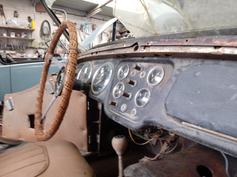

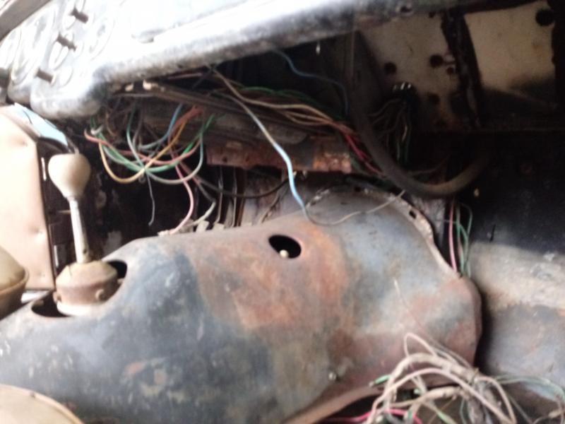

A few more pictures of the srtip down before the work starts

Were the body tags missing? Or just already removed for restoration?
