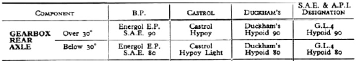

I have searched past entries and I could not find a thread discussing what weight gear oil to use in TR3 transmission. The red Service Manual says in countries where the temperature is over 70 degrees (as it is quite often in North Carolina)to use 50 weight motor oil, something like Shell X100-50. That seems strange to me since the original specification for my TR250 calls for 90 weight gear oil. Is there any problem using 90 weight GL4 gear oil in a TR3 transmission? Thanks!
Regards,
Bob
martx-5
Not that I'm aware of...
The recommendation you have is an earlier one that was changed because of thrust washer problems.
