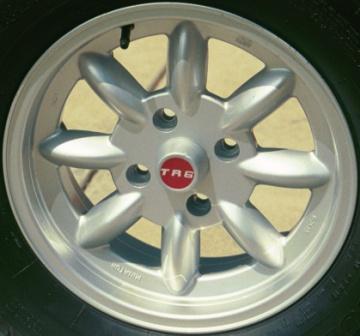

My brother ordered a set of Superlights last week. They come with caps and lugs for less than the wheels alone from the major parts houses. Unfortunately we live 750 miles apart, otherwise I could photograph his Superlights next to my Minators for a comparison.

Superlights has a nice machined lip (like Panasports) whereas Minators are painted and clear coated. Also Minator lug holes require a non-standard sized shank lug nut. I drilled out my Minators to use McGard standard size lugs. Panasports are the lightest of the 3, next KN Minator(15x5.5), then Superlights (~18lbs/15x6)

KN makes a 6" wheel. I don't think any of the usual suppliers in the US carry them. Mine are 6". The previous owner ordered them from Rimmer Brothers several years ago when they ran a free shipping special. He said they eliminated free shipping on wheels shortly after his purchase.
I attached a picture of one of my KN's to my earlier post.
