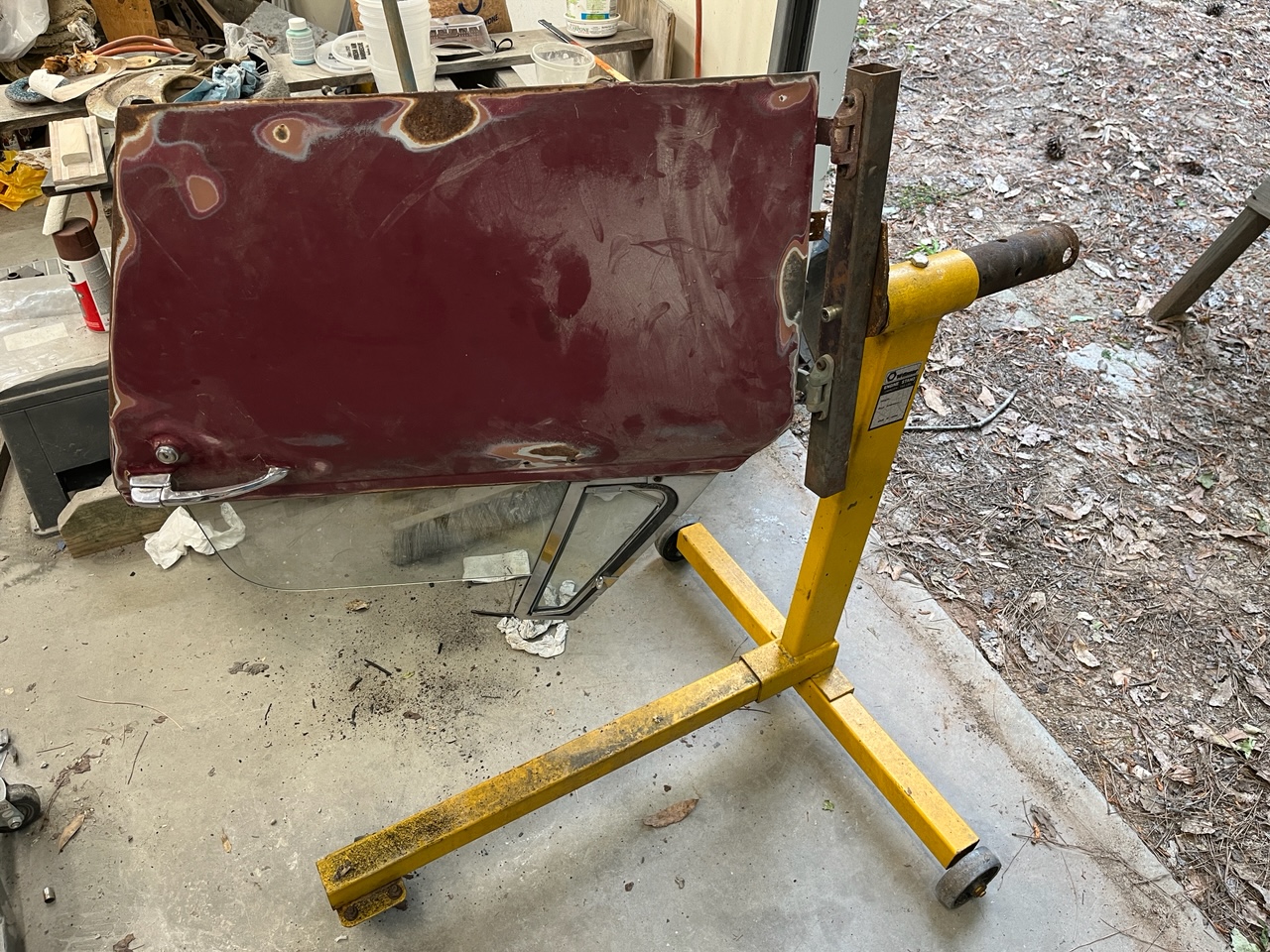

The doors are really heavy and when they are off the car they are a bit awkward to handle. So I came up with this method of holding them. Not sure how well it will work.
David
JPSmit
looks great! clever idea for sure. BTW, when I reinstalled my doors, I changed out the screws for bolts. Then I could use a socket to hold and move the door with one hand and snug it up with the other. Once all was alligned I replaced the bolts for the screws one by one. Glad you are getting back to it. Progress!

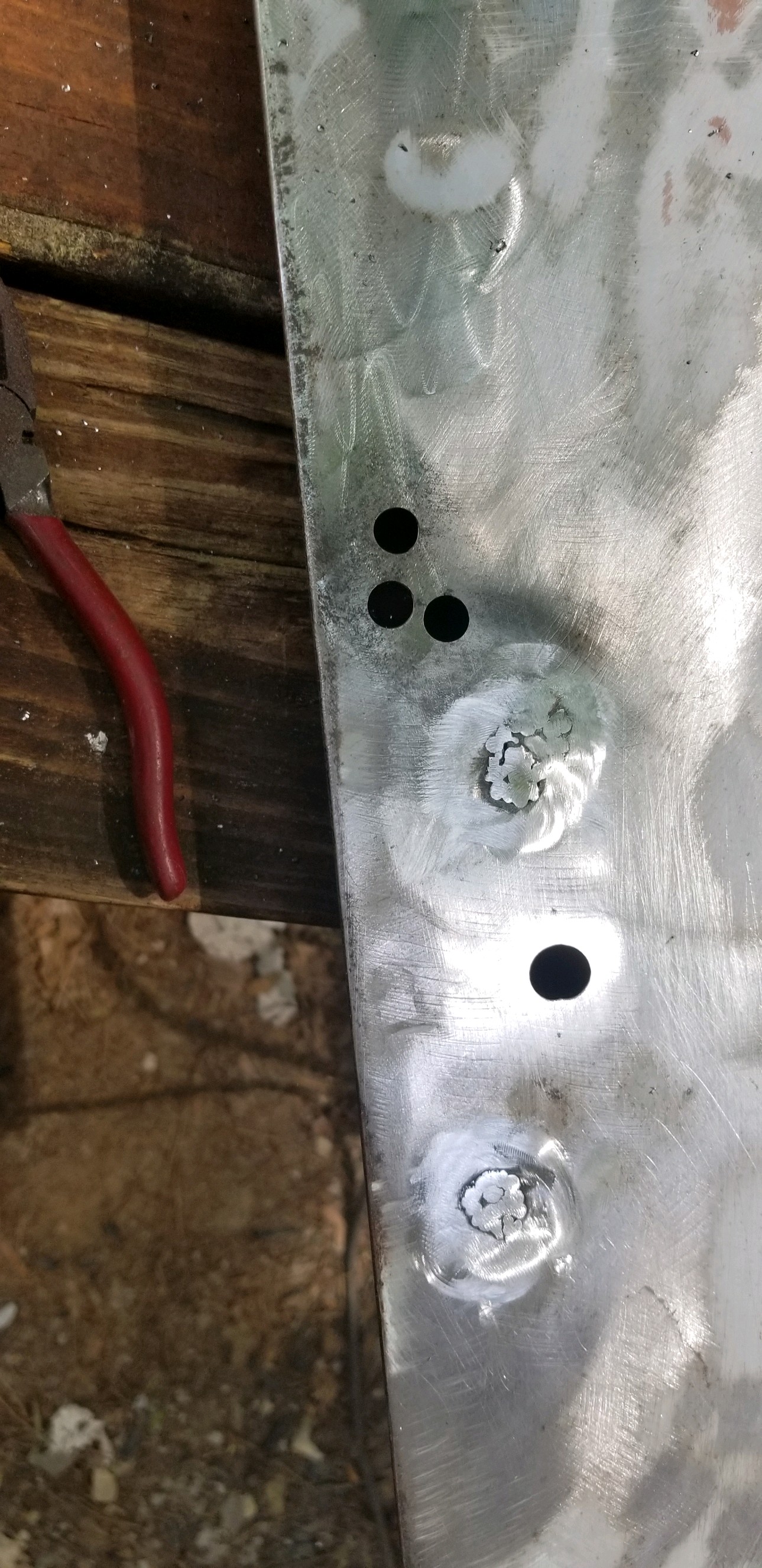

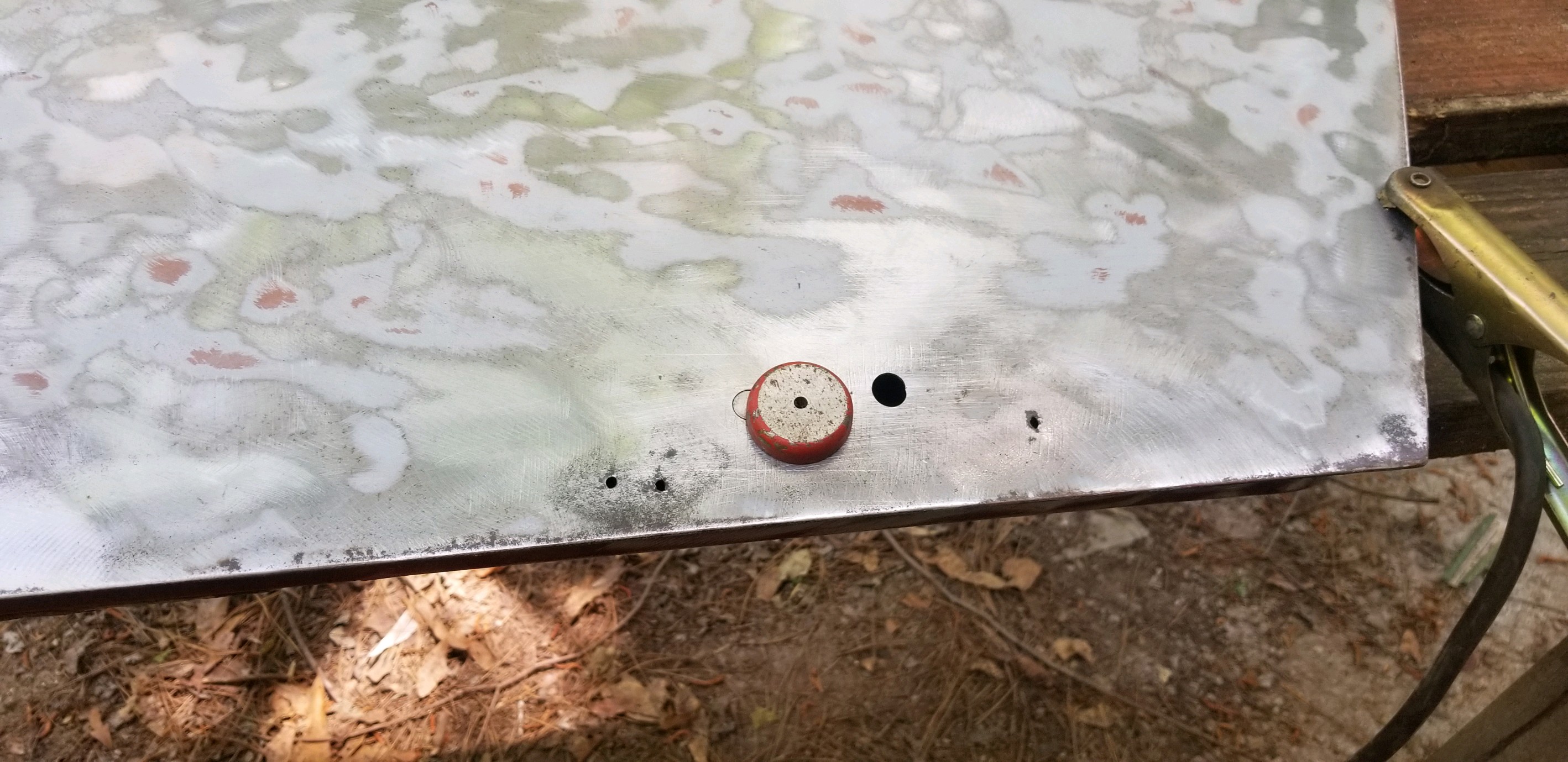

Started welding up the rust pin holes in the door. So far I have not blown through the door skin. I am using a step bit to drill the holes then cutting out discs to fill the hole.

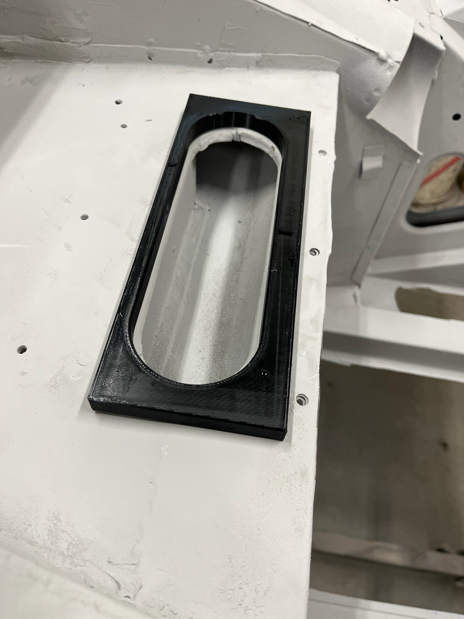

Went out and got a battery for the Midget today, size 51 seems to fit. When I was placing the heater box in the car to judge the amount of room I had for the battery I noticed there is a gap between the bottom of the heater and the air intake to the car. Don't remember what went in there. Some foam packing? It is about 1"
Did run the engine on its stand till it was warmed up.
David
JPSmit
foam packing indeed. I just found some closed cell foam and filled it in.
D
DavidApp
I have a 3D printer so I may print a spacer and add some thin foam to form a seal. Got to find Real Jobs for the printer.
David
JPSmit
David
Smart plan - I recall cutting layers. It is an odd space that I suspect has more to do with a 'parts bin' heater than anything else.
