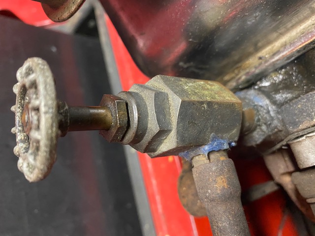

Should I open the heater valve on top of the engine ? I've never touched it and I'm not actually sure if it is in the open or closed position. I can't turn it but I think that's because the nut at the bottom must be loosened first.

Tom, attached is a photo of my heater valve. I'm not sure if it is currently in the open or closed position as I never use the heater and don't know the condition of the heater core. I don't want any problems. I would think it is closed but that is just guess on my part. I'll probably pickup 2 gallons of the Prestone Ready to Use 50/50 anti-freeze and drain the system by removing the bottom radiator hose. Hopefully I'll be able to get my hand under the radiator and remove the clamp and hose without too much of a problem and spillage as I'm recovering from shoulder surgery.

Art - as I remember, turning that knob all the way counter clockwise opens the valve; all the way clockwise closes the valve. If you look at the stem, you see a shinier bottom half, which to me would indicate the valve is open.

That's a good point! So to open or close the valve you first loosen the nut, then turn the valve to open or close, and then lock it in place with the nut. Seeing that you are also in Connecticut (I live in Guilford), I'm curious if you have your heater valve opened or closed. Thanks again.

NO do not touch the nut. It works just like the hose bib on your house. Only turn the handle. Open or closed.

The nut under the heater valve tightens the packing that seals the stem. Only tighten that nut if the stem starts leaking.
