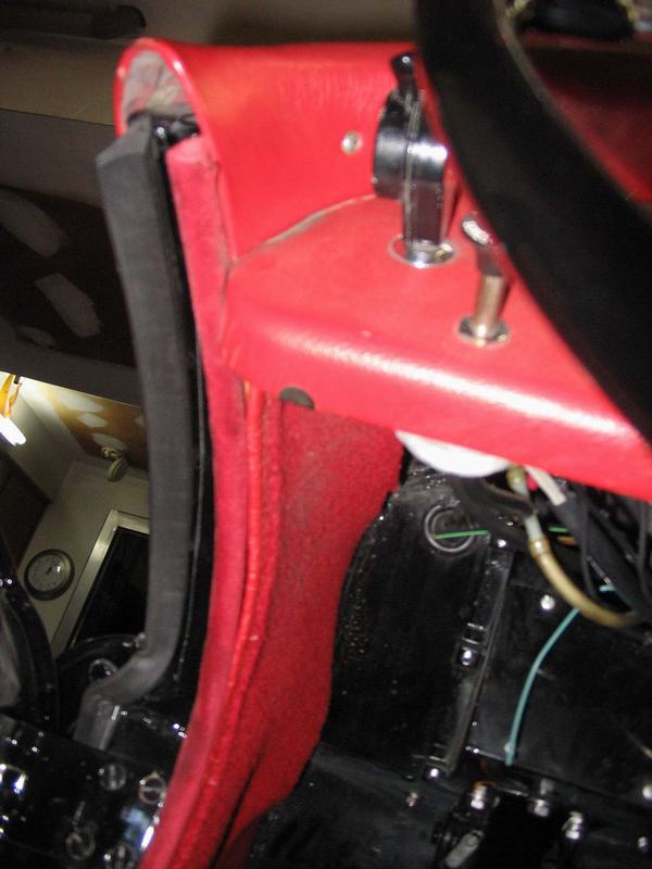

I ordered a door seal kit from TRF. My TR3 was a stalled project and the rubber had been removed and so I don't really know how the rubber goes back on. TRF is assuming that I do and included no visual or written aid. The online catalog gives a vague description If you are familiar with the door seal kit I know the long piece clips to the bottom of the door. A shorter piece glues on the end of the door another piece clips to the shuttle on the curved part of the upper door opening. I'm left wondering if the hinged area takes a seal. I really don't know where the <span style="font-weight: bold">fuzzy</span> strip goes unless it goes on the tendon plate to seal the storm curtain at the side of the windscreen. Any tips you might offer would be appreciated. It is an odd place for a photo but if you have a photo or a link that would be appreciated too.

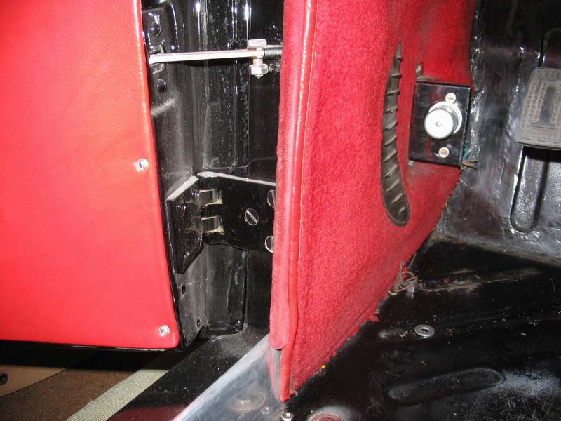

There is no seal up the door near the chromed latch plate nor is there any seal on the door up the front where the hinges are located.

Here is a photo I took when a TR3A owner in Spain asked this same question.

Thank you for your time Don. Your posts and photos were extremely helpful,
I see where that fur flex (what I was calling fuzzy) goes now. I don't have any kick panel carpet in so I wasn't visulizing it being there. Seeing how you have yours makes sence now. I saw where you posted on the other thread in regard to cutting the rubber a 1/4 inch short and rolling the fabric back into the tube. That is a great idea.

TR4nut
Don-
Excellent pictures, thank you as well - these technical closeups are great resources, especially in the case of acquiring a project in boxes or forgetting how you just took something apart.
