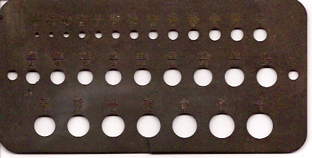

I hold a screw up next to the holes in my plastic drill gage to get an idea of what size drill I need, then like Geo said drill a test hole in a piece of scrap wood to test the size.
Start with a slightly smaller drill first and if the screw is to tight then I work my way up to a larger size drill if necessary. Also attempt to use a similar type of wood, since if you use a softer wood for the test you may not have a large enough hole.
