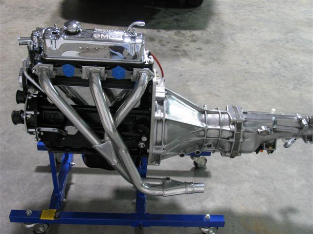

frankssc1800-2 (1).JPGIt's call a Siamese port, it's not that uncommon, and for sure not just a British thing. On most MGs, like the MGA, MGB, A series engines found in the Midget, Sprites, Mini, etc. they are all 5 port heads, three exhaust ports, cylinder #2 and #3 share the same exhaust port, and on the intake ports #1 and #2 , and then #3, and #4 shared the same intake port. Here's a better look at the head, with a header bolted up, this was a MGB engine I built a few years back.

And since the firing order is 1-3-4-2, that center port is effectively one for each cylinder when being used.
