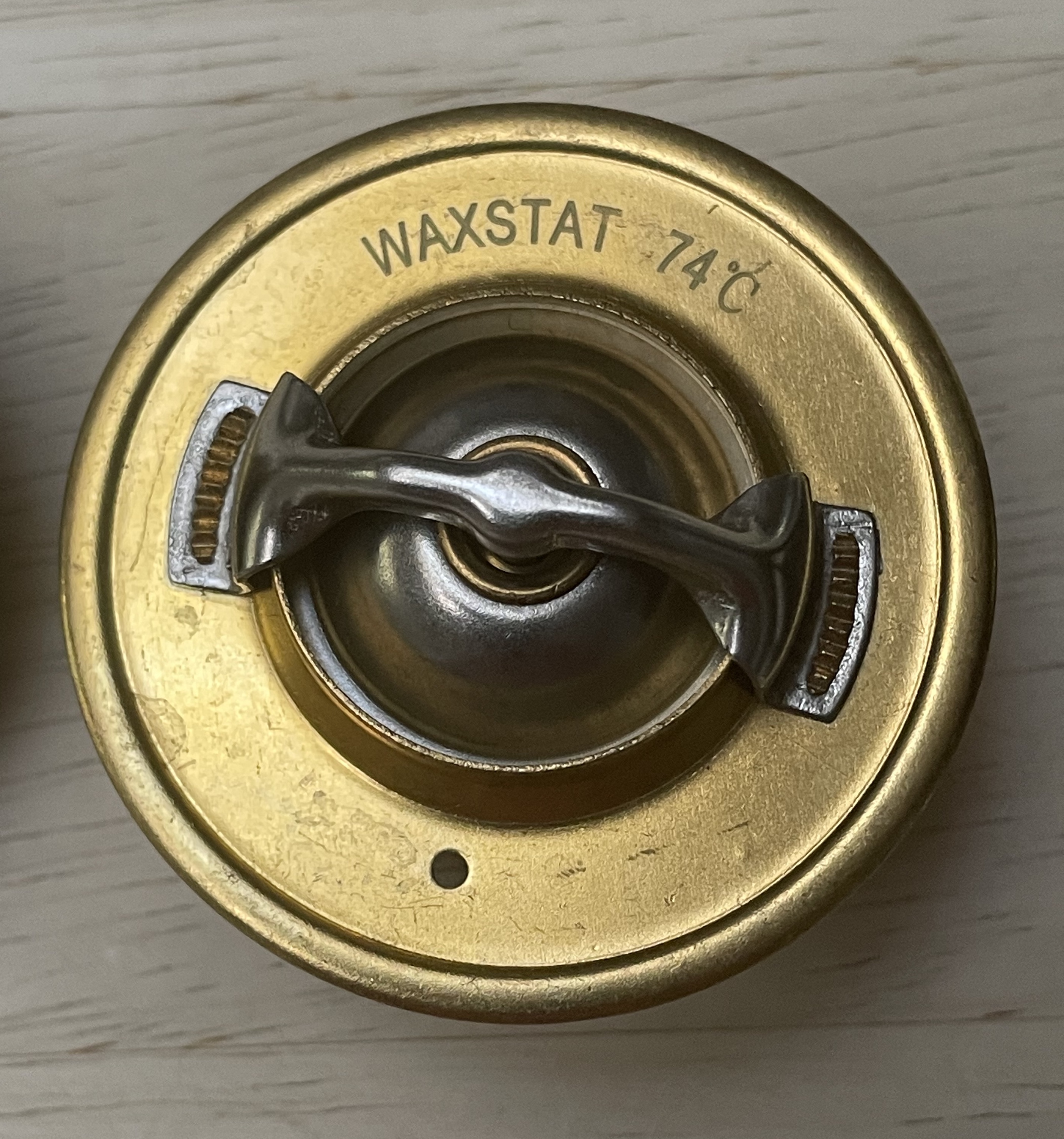

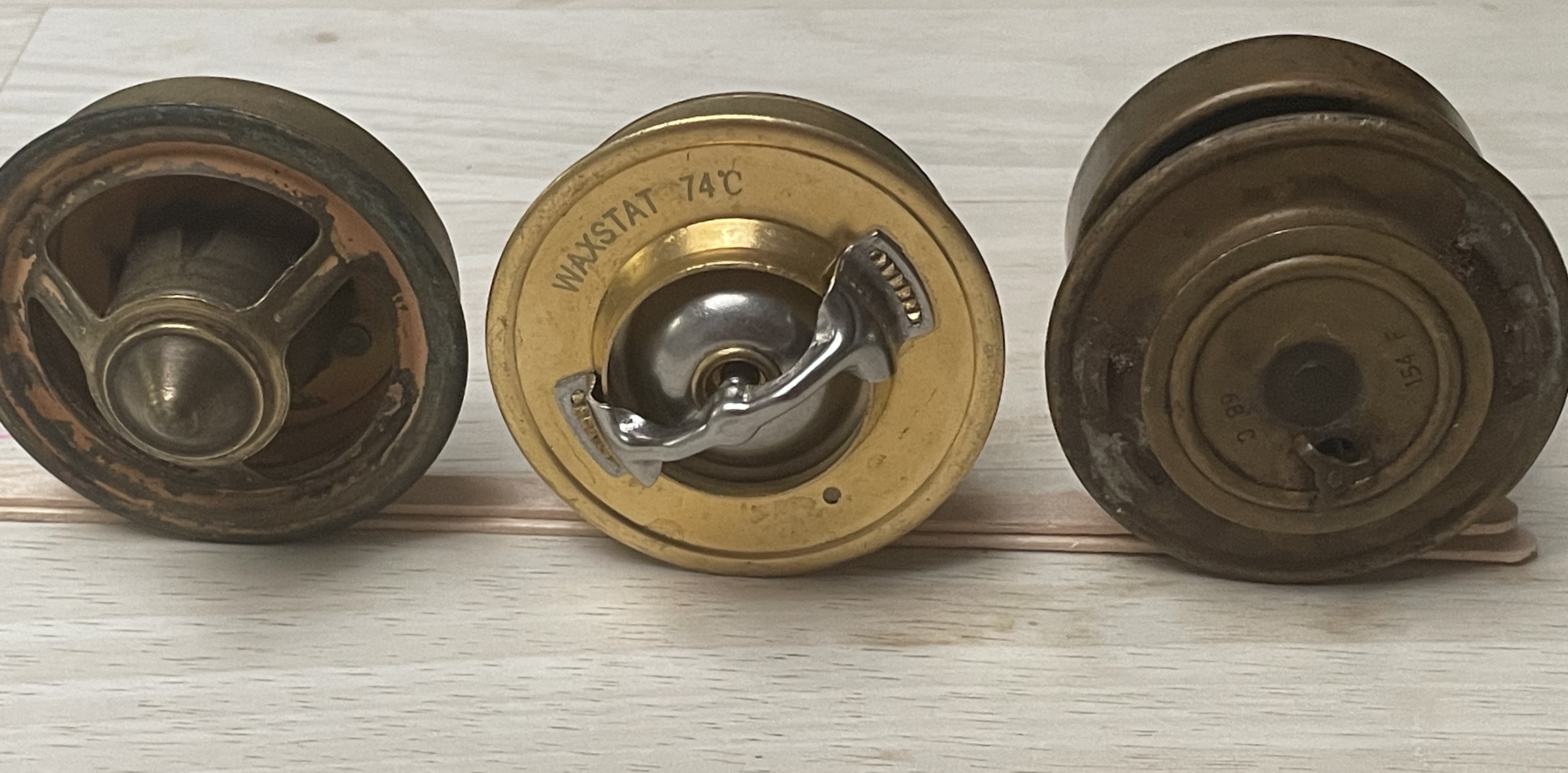

My new thermostat that I ordered from BCS came in today and it is the shiny one in the center. It is a 167 degree F and is stamped “WAXSTAT” 74 degrees C.
I did a little bit of measuring on the outside diameter of the ring and the waxstat is the smallest diameter. The Robertshaw one is the largest diameter and the bellowed one is very close in diameter to the Robertshaw one. The gap on the waxstat is a 1/16” smaller diameter compared to the Robertshaw one which means, imo, that the ring will allow more water to flow by it and David Nock did confirm that. The waxstat also has a small hole that should take care of bleeding off the air in the system.

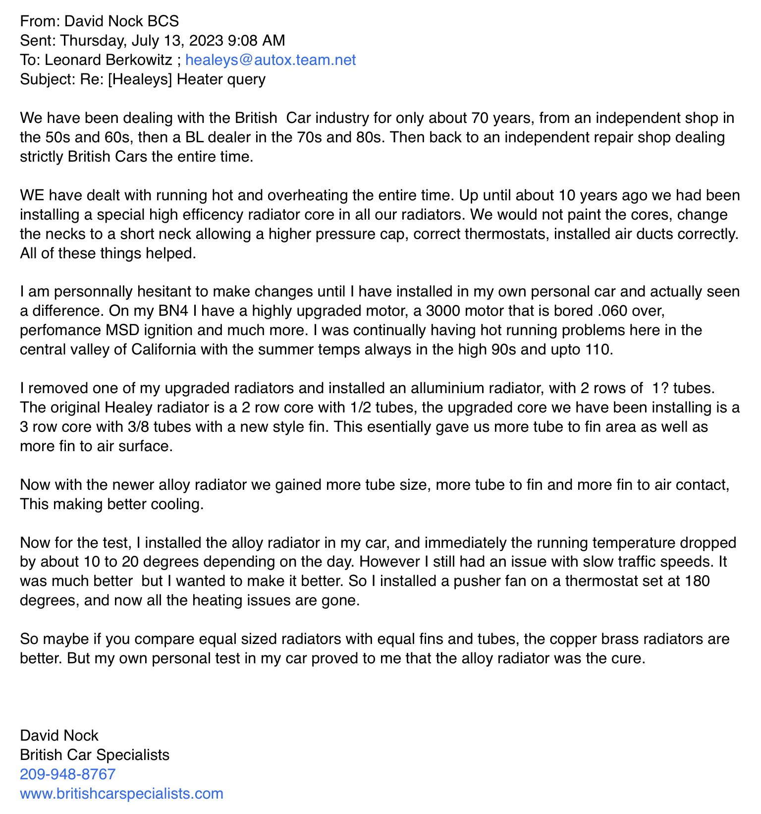

I found this on a Facebook site last month and saved it and I just found out where I saved it., (don’t ask where) Let me clarify my "don't ask where" comment. I found it in my wifes "cooking files" files. How it got there, I do not know, but I must have saved it there.

WHT
Hi Patrick,
Looks like a great recommendation.
I think that will be our next change to the BJ8. So far, running temperature has been no more than 190F; but I have not tried driving it at 108F ambient yet since it is down as we install a new leather interior (almost finished). BTW, I saw one of your posts on installing carpet with the recommendation to buy a "good" pair of upholstery scissors. Thanks, doing so really helped!

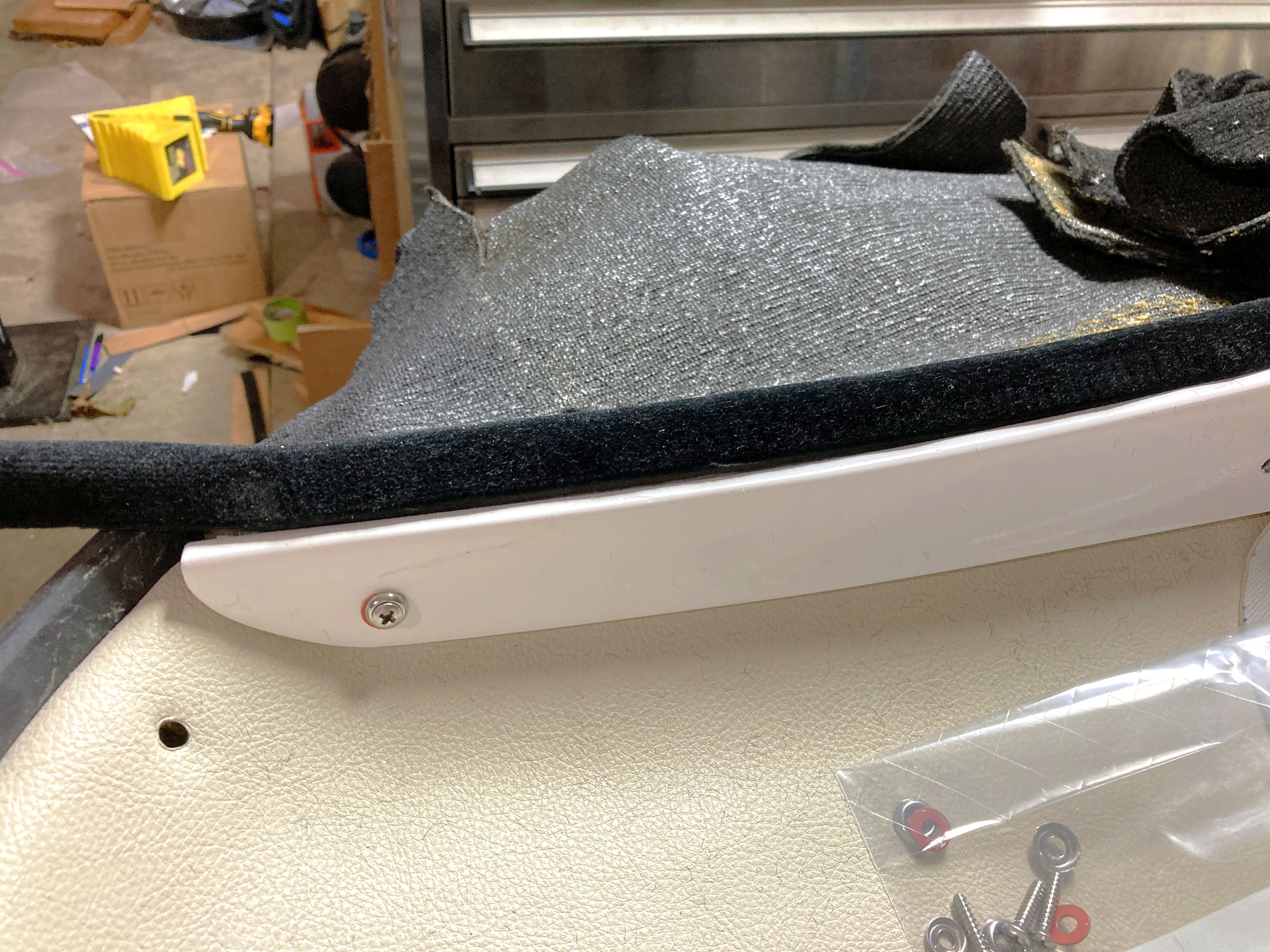

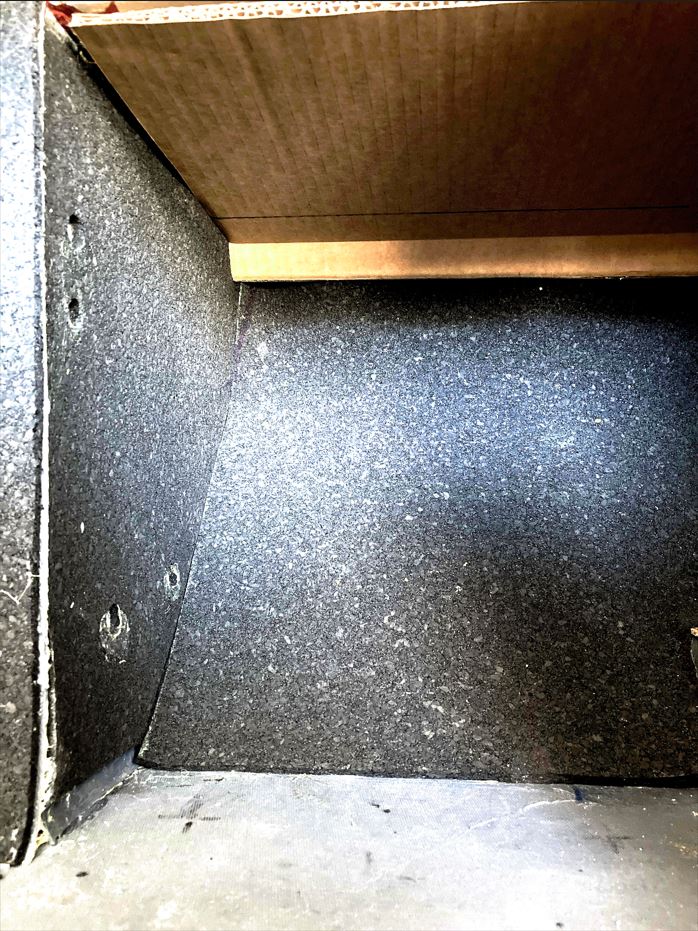

We spent a lot of time and effort to seal the car to improve heat transfer and road noise. The tub and tunnels were covered in KoolMat and then with 1/4-inch closed cell waterproof foam sold for boat decking (and used here as a replacement for jute). The foam was glued to vertical surfaces as would be jute and left unglued on flat surfaces for removal if needed. The KoolMat is sealed like a shower floor liner and the tub is waterproof.
Used a press and silicone adhesive to glue the waterproof foam to the silicone side of the KoolMat around the toe boards and transmission opening (other adhesives will not stick to this side of the KoolMat). And then, I glued carpet to the foam as you would normal jute. The first picture shows the fiberglass side of the KoolMat, and then the closed cell foam glued to the outer silicone side.
The second picture shows the KoolMat/foam composite glued to the toe board areas and transmission tunnel opening. Holes were punched in the KoolMat and foam so they would lie flat over bolt and screw heads. The holes were later filled with sealant.
The last slide shows a cardboard form used to make a template for the fiberglass covers I mentioned. The cardboard was used to make a wood mold to layup fiberglass covers to close off open area on both sides of the car. Everything in the opening was first sealed with grommets before installing the covers; but, the covers are an additional "layer" of sound and heat proofing. I realize, most people don't cover these openings.
The floor carpet snaps were sealed with automotive seam filler on the bottom of the BJ8 so the entire structure is waterproof inside and out, Not that the car will ever see water! :smile:

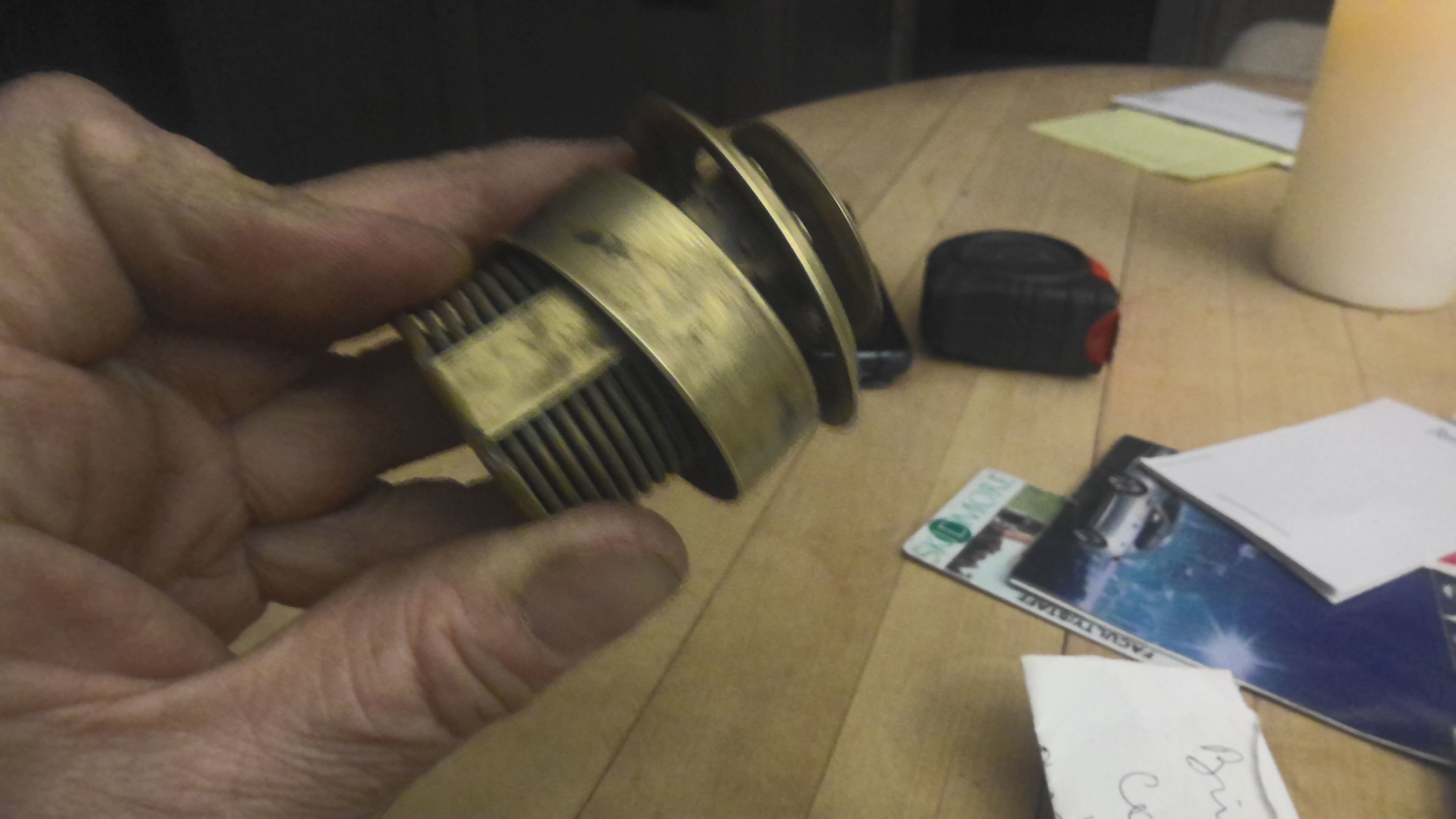

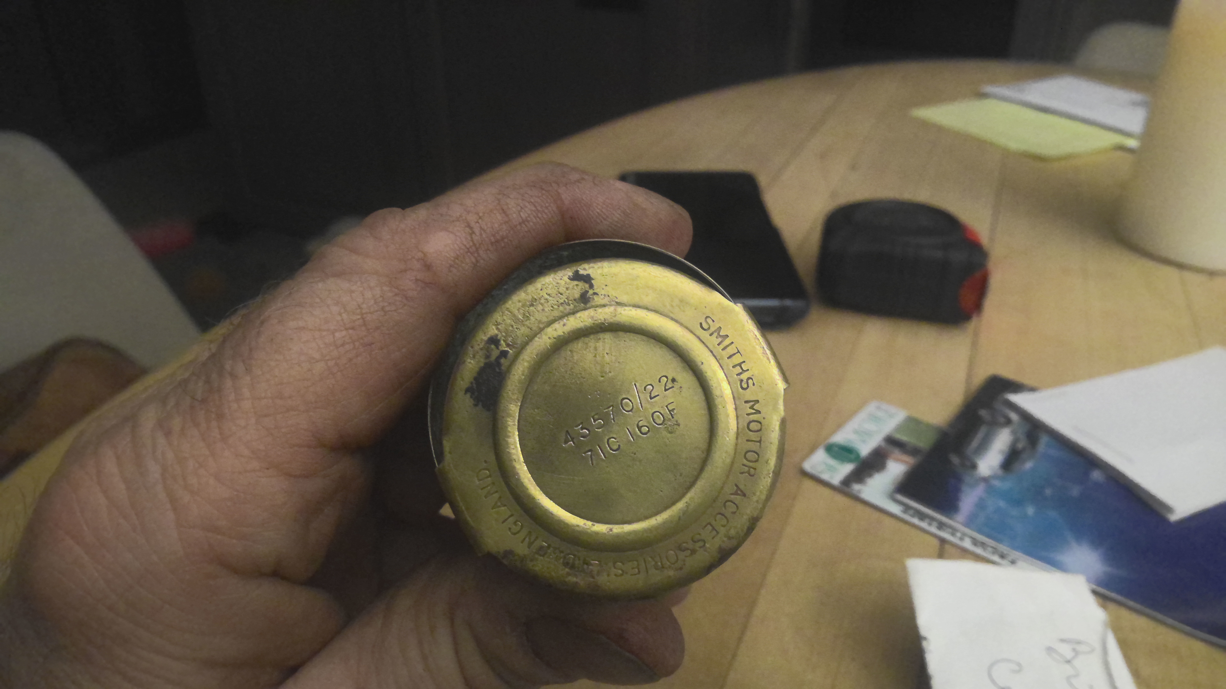

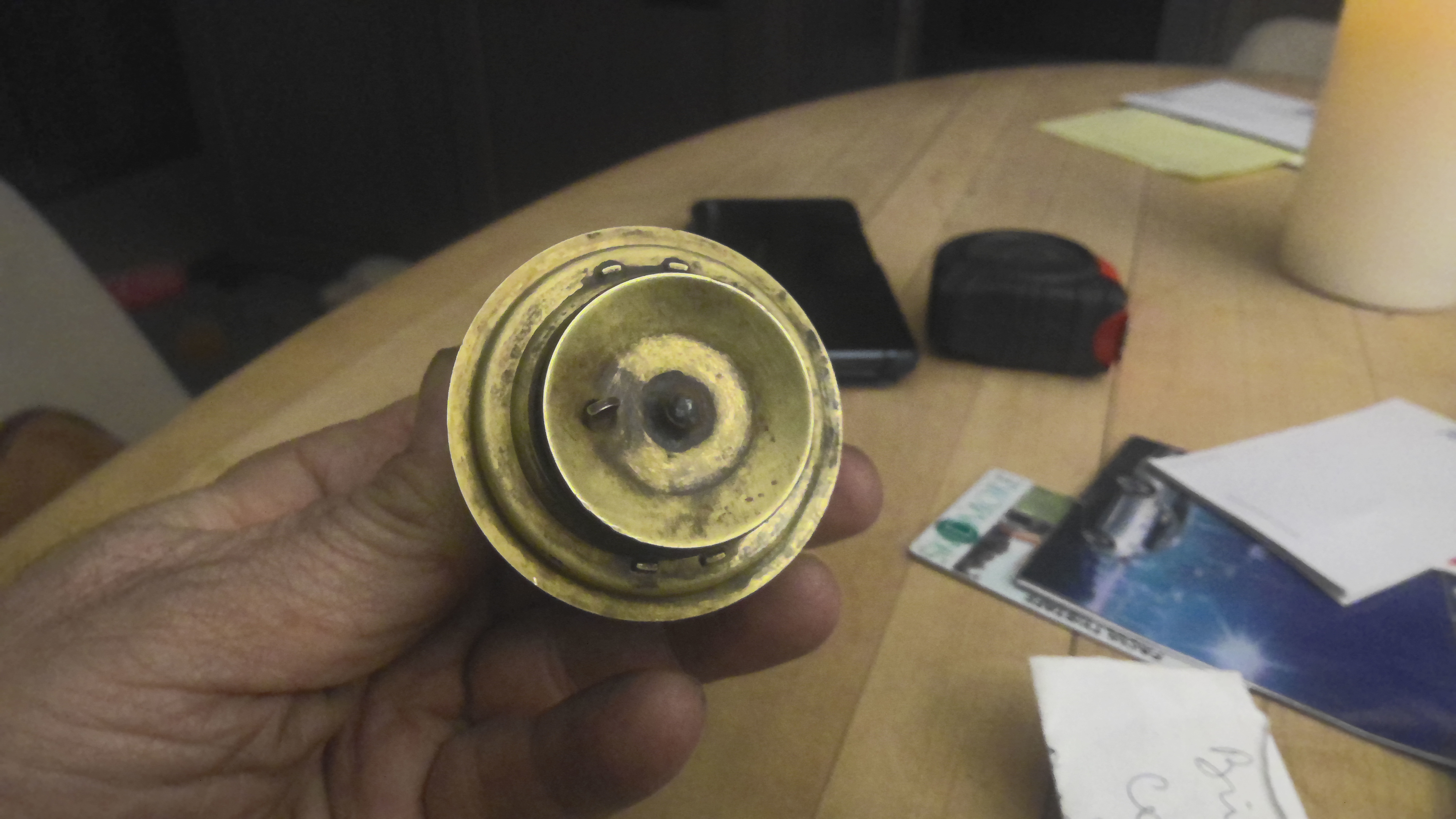

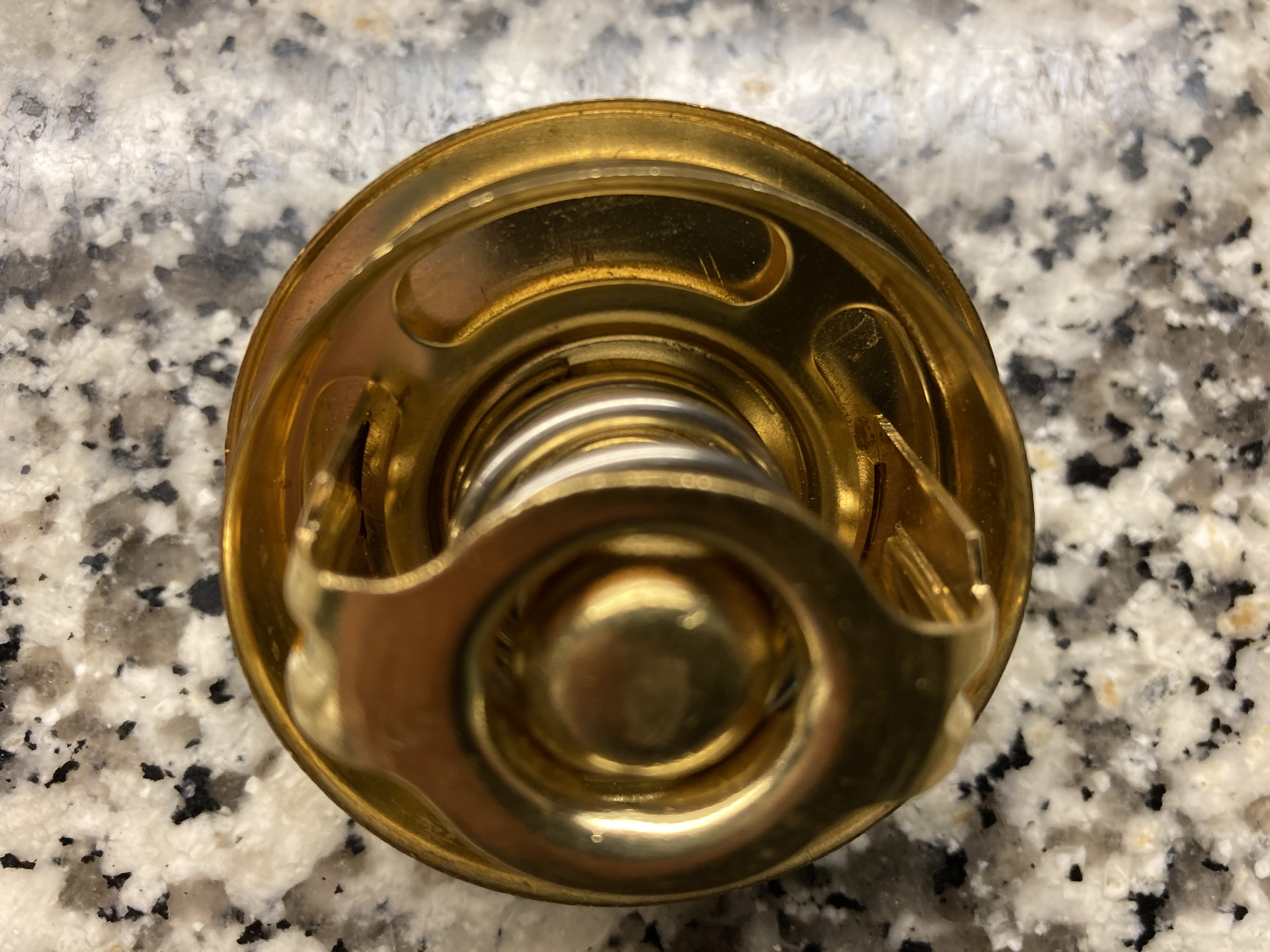

Hello, hoping some of the preceding dialogue-folks are still paying some attention to this riff.
I purchased a 57 TR3a with many of its parts in buckets. One is a bellows type thermostat, as pictured below. I'm wondering if this is one of those originals that some people prize, or is it a later imitation. Original picture has tons better resolution. States: "Smith's Motor accessories," "43570/22," as well as "71C 160F."
Any info would be appreciated.

steveg
I ran a fail-open 180 with a cutaway Moss blanking ring for a while. I used a second green gasket to compensate for the double thickness of the metal parts. The blanking ring was cut away except for enough to cover the transfer port.
