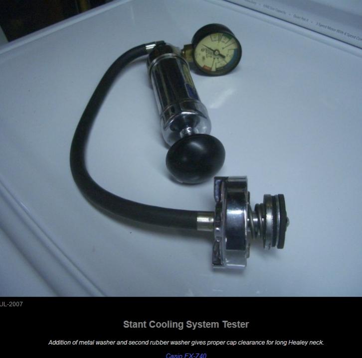

Steve, Does this tester have a cap that seals 'long neck' Healey radiators, or did you have to mod something up?
steveg
Bob - This is how I did it when I got the Healey 19 years ago. It comes with various spacers for longer necks. I always wet the gasket and it seals fine. The gasket isn't cracked and has never been replaced.
