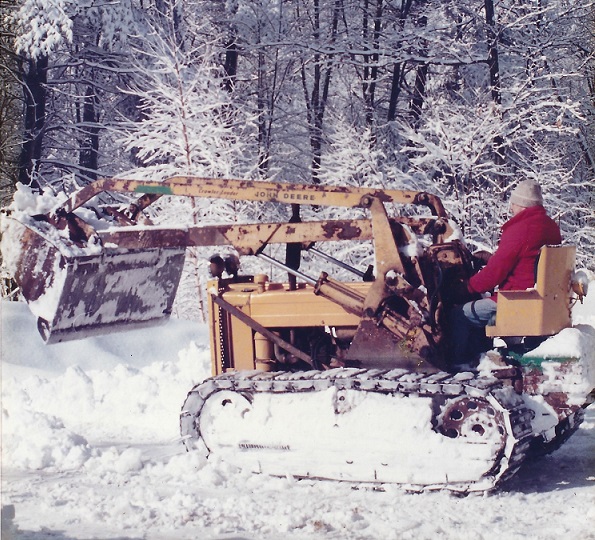

Apologize for hijacking your post but couldn't resist. Here's my 1950 something John Deere 420 track loader. I made my 900 foot driveway, among other things with it. 2 cylinders, 2 liters, no water pump and heavy. I bought it when I built my house a bit over 25 years ago. In low gear and full throttle (1800 rpm) it's forward progress was extremely slow but almost unstoppable. I had it for 25 years before I sold it in a weak moment (for domestic tranquility) 5 years ago in favor of a newer Kubota that looks a bit more presentable but is toy in comparison.

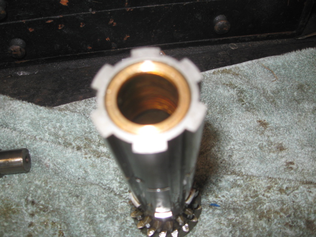

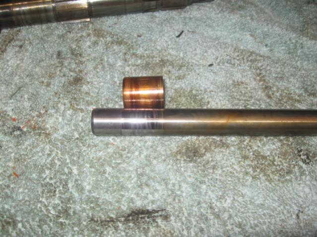

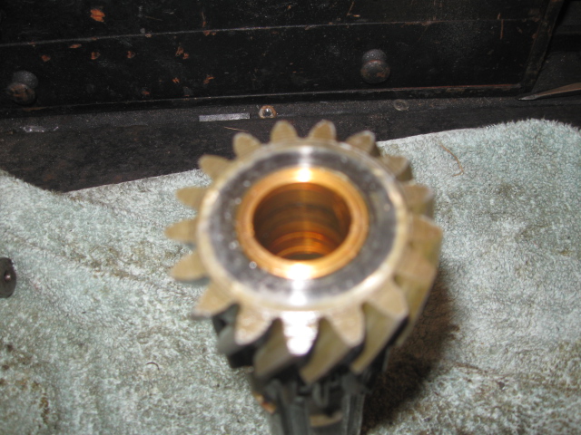

Funny thing about the 3 synchro boxes. They used large diameter full complement loose needles in the countershaft gear and never had (AFIK) problems. The caged bearings used in the TR6 transmissions are known for their self destruction. Maybe the increased torque of the 6cyl engines is a factor.

I see there are new counter shaft gears available for TR6 that accepts 2 rear bearings on he counter shaft so it would carry twice the load. Spread the load out and less wear. I'm thinking the original gears can be bored to accept two bearings?
I saw those in the Moss catalog at $400+. The bore on the original gears are quite hard, maybe from work hardening. I managed to machine one on my lathe using carbide tooling and the slowest speed, but a shop with an internal grinder would be a better choice. I think hard acceleration in the lower gears causes most of the problems with the rear countershaft bearing.
