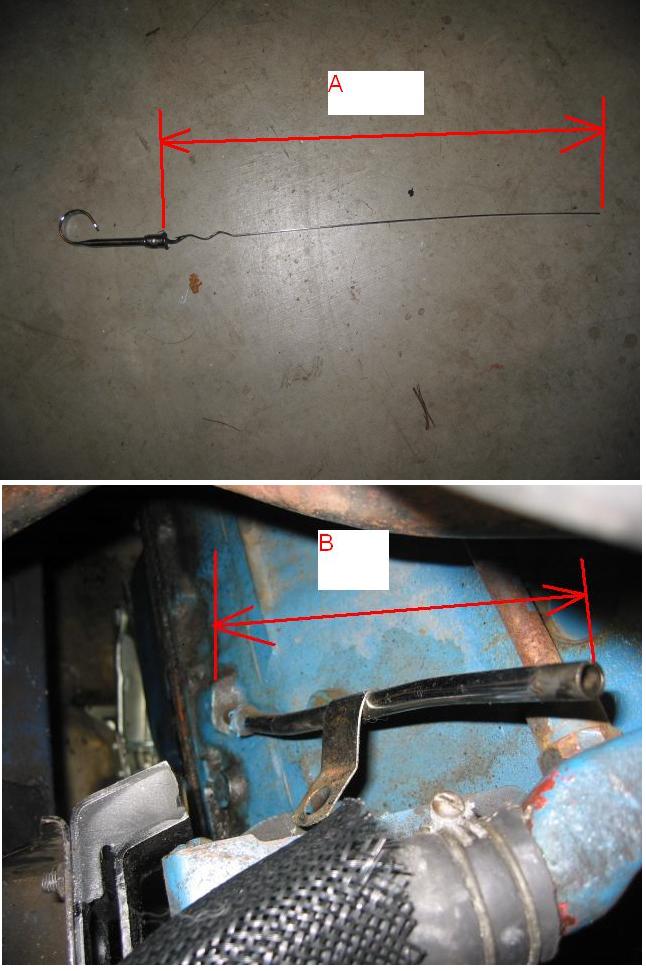

I am not just looking for the length of the dipstick, but the length of the dipstick tube. I am wondering if I have the right dipstick and dipstick tube since when I fill up the engine with oil, the mark on the dipstick is not at the full range (rather it is above the full range)
Need dimension of the dipstick cap opening to the end of the dipstick (Dimensions "A", see attached picture).
Need dimension of the dipstick tube from the end of the tube to the engine (Dimensions "B", see attached picture).

Well, neither of those in the photos are a 948 or 1098 dipstick or dipstick tube!
