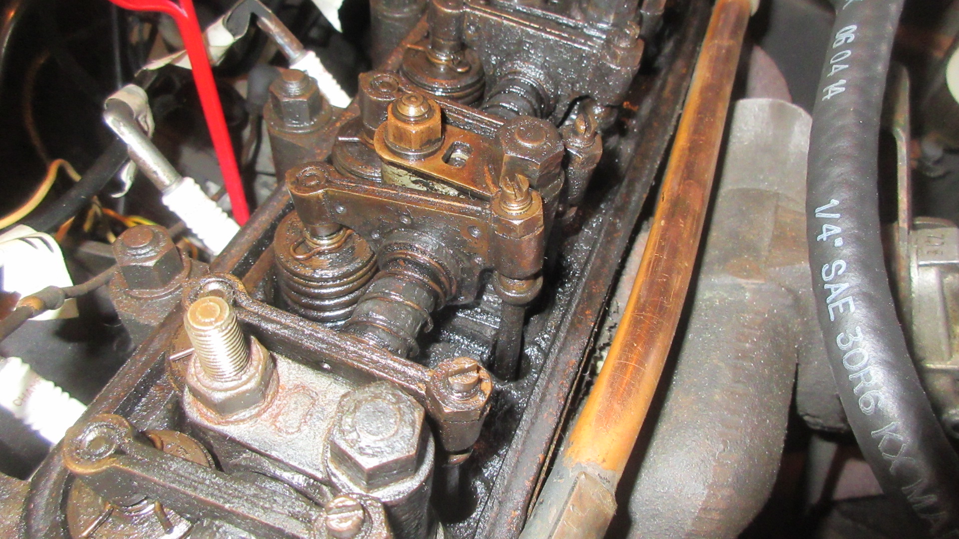

When checking the valves, I found a "bit" of sludge, about 1/16th thick.
I know I can use paint thinner or degreaser, and will use that to remove the sludge on the underside of the valve cover. But how do I remove the sludge that's on and around the valve heads? I don't want to wash it down the valves and rod holes.

Tom, this you will not want to hear, but: "let sleeping dogs lie." Clean the inside of the cover, yes, but don't mess with the rest. That is evidence of neglecting oil changes, pure-n-simple. You start disturbing the sediment and it WILL find its way into bushes & bearings.
Change the oil & filter several times at 500~1,000 mile intervals. Either plan on a full engine rebuild or look for another one to rebuild and swap in while you do that one (if original to the car). You could R&R the head and oil pan, clean those up and hope for the best, too.

I figured there was danger about crud going "down inside" - thanks for reinforcing my thoughts there. I scraped loose as much of the sludge as I could, then brushed/wiped it up. Then attacked the valve cover, which took grease cutter, paint thinner, wire brush, and flat head screwdriver to loosen the sludge. Literally had to chisel (using screwdriver) some of the hardened mess loose.
Girded my loins, re-assembled and re-connected things, ignition on, cranked engine, and ... it started immediately. I slowly raised it to 2500 rpm and kept it there for ten minutes, getting it hot, let it idle, then returned to 2500. I kept fearing a slow and painful death - but engine operated normally. There is a random miss at high speed revs (not idle), but that existed prior to my cleaning today. I figure (hope?) it's a coil issue.

The degradation from loosened "sludge" will not come as an immediate problem, rather over time. Change oil & filter a few times at 500~1,000 mile intervals, as suggested above. Wouldn't hurt to put in some of that "mechanic-in-a-bottle" Lucas oil either.
Platinum
How 'bout Seafoam into the oil filler, per Seafoam instructions? one ounce per quart of oil.
I doubt it will do any harm. But again, a few oil changes in succession as well.

I know nothing about Sea Foam in the crank case, having first heard about it very recently. However, the stuff works (albeit very little) elsewhere by dissolving the petroleum gunk that keeps offending deposits in place. These deposits were once in your oil, which is how they got where they are now, so I wouldn't think that enlarging them back into the oil for a short time would hurt much. But, you should probably change the oil very soon after adding Sea Foam.

Thanks gentlemen. As a side note, I used Seafoam on my 1958 Rambler about ten years ago. I'd found cylinder compression (on the flat head six) to be something like 150 145 150 150 90 145.
I put two tablespoons of Seafoam into that low cylinder, let it sit over night, ran the engine, then tested again. The 90 had gone up to around 145.
I then used the "two tablespoons per quart oil" method, drove 100 miles, changed oil, and the dark exhaust smoke was greatly reduced.

Seafoam was orignally made for outboards. I use it to clean valves out of head, does good. Back in the 60s-70s we used to run transmission fluid as a cleaner, 1 qt during oil change, drive 500 miles and redo oil change and filter. Oil was cheaper then. But, I agree with Doc, change oil a couole times with short intervals. These older cars had non-detergent oil and were specified to be changed at 1000 mile intervals.

You know what I am saying. The old non-detergent oil had to be changed more often as it did not clean. 60s started introducing the modern oils. You can keep using non-detergent, but sludge will increase. What you have is from lack of road use, sitting a lot. Just change oil and filter couple quick times then maybe just filter until you see some improvement. The old English cars had a lot of not tight tolerances so what sludge that starts washing off should have minimal impact until you want to go further into it. You don't hotrod, so you should be fine. Ask your buds at the museum, they do the old planes with you.
