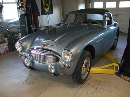

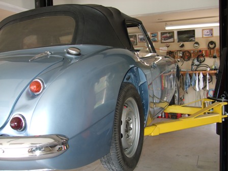

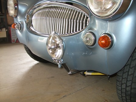

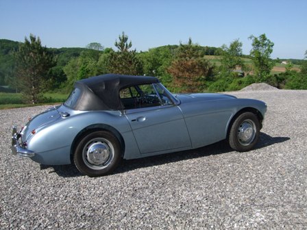

Hi BG, When I painted my Healey this past winter, I used 1979 Ford Thunderbird, Light Blue Metallic. I had painted the Thunderbird about ten years ago and when I was hunting for the right colour for my Healey I came across a test panel I had painted when doing the Thunderbird. I said 'That's it. Close to almost if not perfect." I don't have the paint code or the correct name at the moment but it you need it I can find it. But you can find it by looking at the 1979 Ford colour charts. I believe Thunderbird colours are broken out unto a separate chart. It is deffinately best to use Lacquer or Base/Clear paints to do metallics. Base/Clear is very good because you can dust the metallic on to get it very even and you can besure you are very satisfied with the metallic before you spray the clear. I use Matrix brand paints which are a knock off of PPG. The metallics usually come in 3 different sizes. The paint code for the colour I used uses the small metallic. I will try to attach pics of my Healey large enough that you can see the finish. Dave.

When I painted the t-bird I used a Dupont Chromabase paint. But when I got to doing the Healey, I no longer had a local supplier for Dupont paints so I went with the Matrix brand paint. The Matrix brand paints kept mixing up alittle darker than the Dupont so I had the shop lighten it alittle. I had already painted my interior, trunk and engine bay with the Dupont so I was trying to match that. The final exterior paint is the Matrix. I sprayed about 4 test panels before I was happy with the final colour. I will try to attach some pics of the two colours. Lighting and the camera has a significant affect on the picture but the two mixes are so close that no one can pic it out.

That color sure looks right to my untrained eye. Thanks Vette. I will look at it. I saw Wedgewood Blue samples but only some of them looked metallic. Others called Wedgewood blue looked way too dark. Ford did some crazy stuff with color during that time period.

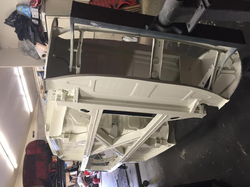

hi Bill- attached (if this works) is an image of Cool Vanilla from a 3000 on the rotisserie at Healey Lane Restorations of Marcola, Oregon (John and Robert Wilson). It's a very nice color and looks great in person. I apologize for the strange orientation, I couldn't rotate the image. But then again, it's an image of a frame on a rotisserie.
attachment.php
attachment.php
A few more pics. Sorry again for the orientation
attachment.php
