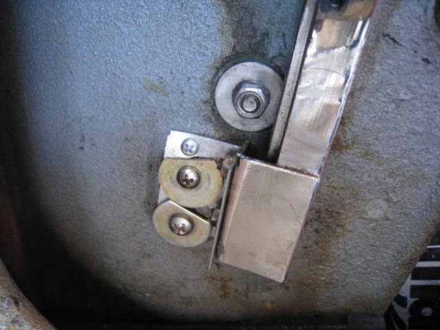

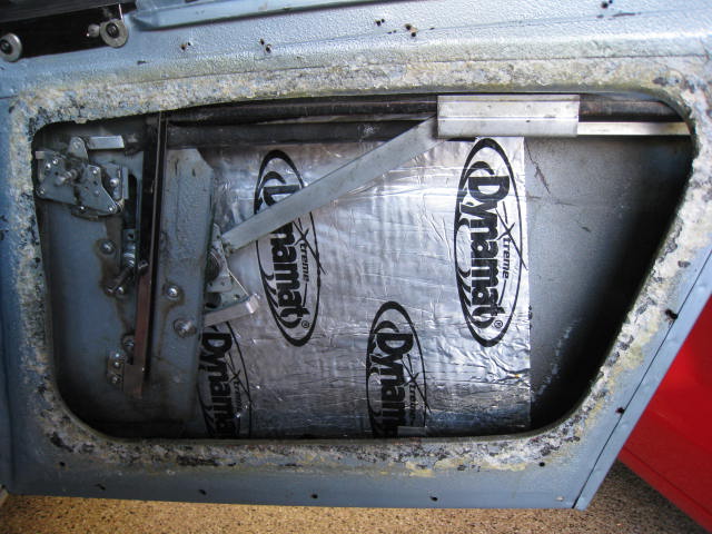

Hello Dallas,
If you're a hands on guy, you can fix everything.
The doors are adjusted by putting shims under the hinges. You may only need a shim under one hinge or multiple shims under both hinges. Trial and effort and you find the right combination.
The glass is adjustable too. It will move forward, back, the angle and slant can be changed too. Height adjustment is made my the stop lever at the window regulator (picture 2). Angling the glass in or out is done by adding some spacers at the bottom of the front window track (picture 3). The rear window track has movement side to side in the edge of the door too.
If after all adjustments to the glass are made and it still does not line up with the top, then you need to look into the top frame/wood/aluminum rails for adjustment.
I'd start with the door hinges, then take the door panel off and make adjustments in there.
Good luck.
