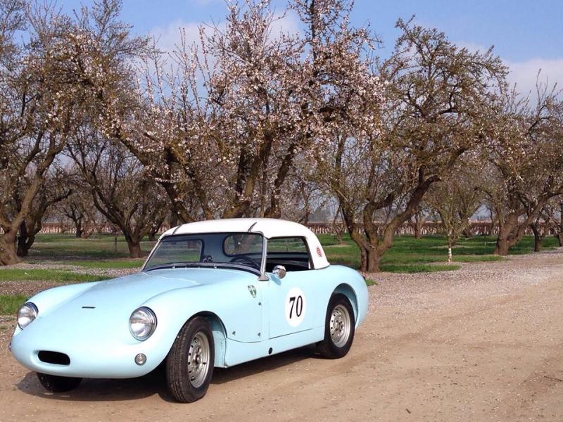

Next weekend is our annual American Graffiti Parade. I have entered my 59 Sprite with a Monza bonnet. I have not had any cooling problems, but I have never spent 2 hrs cruising downtown in 100 degree weather. What should I do to prepare for the event? If you remember the movie, a bugeye was one of the few British cars. One other Q, hardtop or no hardtop?

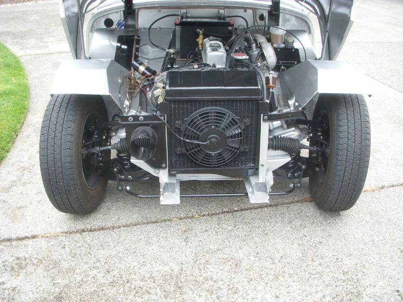

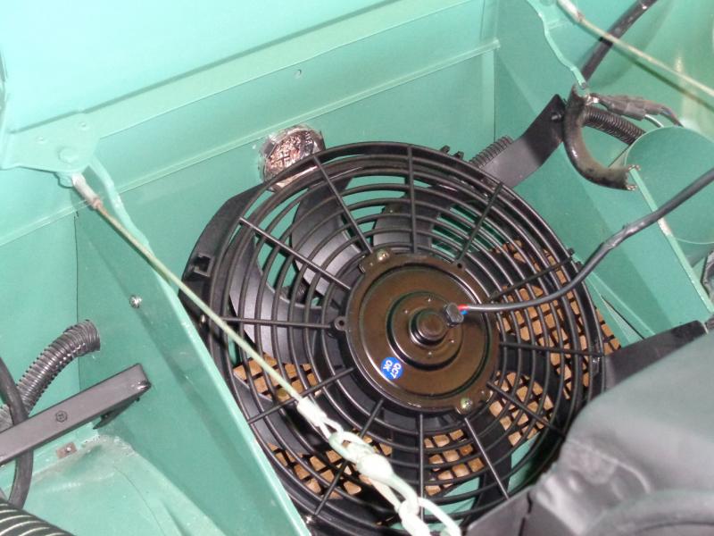

We saw this type of add-on at the Lake of the Ozarks. Looked like a good idea there so this spring I added one. Works really well at idle. Then added a flex a lite controller with a 10 deg dead band and manual/auto switch. Works surprisingly well at idle time in the garage and those pesky stop lights. Fan is a 12" scored on sale from Auto Zone.

All good ideas guys. Thank-you. I have ordered an electric fan and will follow your advice. I have been on call this weekend and it has been hot (104 F). Good news though, by Friday temps will be in the 80's. I have an idea about mounting it based on leecreek's post. I hope it arrives in time. I keep you all appraised of my progress.

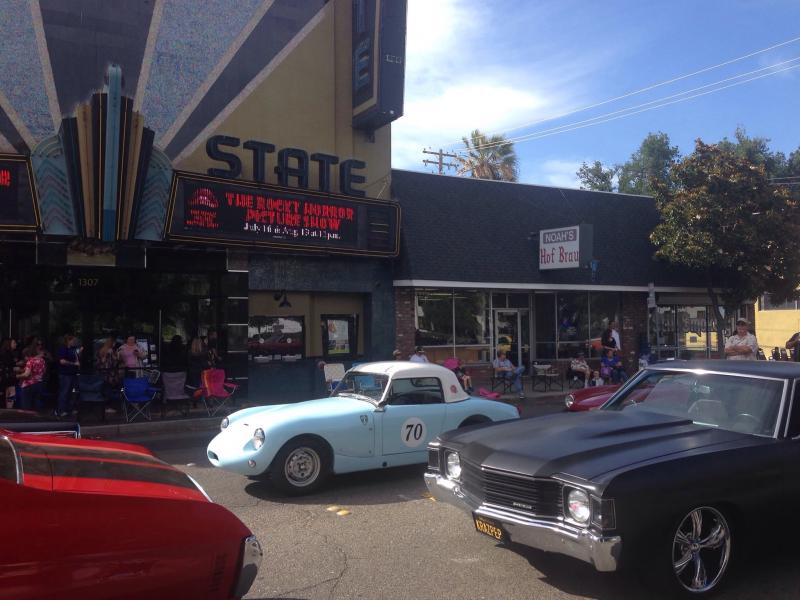

Here is an update. We had a great time. The fan did not arrive until Thursday afternoon (Friday parade) so no time to get the new fan intalled. My date ( my 16 yr old daughter) were parked in front of the historic State Theater. I have had the car stand at idle for 40 min in the garage and my Temp never went over 170. I thought we would be good. We got lots of complements, pics and questions during the cruise. We also saw lots of cars being pushed off the route. Then it was our turn ��. Temp gauge was at ~185 and sudden death. Vapor lock, rolled of on a side street and after about 2 minutes she fired backup. We have never had this problem before but have never been in a parade. Realizing, that it would happen again we went home a little disappointed. At the show on Saturday, I was told that this has been a problem. Seems may of the dignitaries at the front of the parade are sitting on the trunks of convertables, which keeps the pace to slow for these cars. Lesson learned. In a crowd of 1500 cars we counted about 10 LBC (even a mg midget with a bugeye bonnet). Will do it again, with a little more prep.

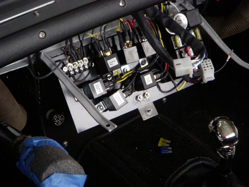

BillW
I was wondering how you wired your fan?

Temp for the day was only 84F, but my fuel line follows the stock bugeye route under the frame rail, under the header to the front for the motor, where it would normally attach to the mechanical fuel pump. Without the fuel pump and using a Weber 40 dcoe, I have a long rubber fuel hose and I think that might have been the problem. I willl use leecreek's idea to mount my fan in the shroud that came with my Speedwell Monza Bonnet.

Paul, I think the problem with these cars is not the radiator. Its the air flow and your car look even more restricted.
The wiring in my car is not even close to stock. I have everything on relays and all the switches ground relays. I don't know if that is the proper way but it seems to work fine. I did my car before I was aware of Forums and deviated from stock quite a bit.
