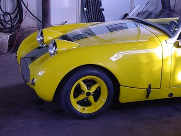

Jim_Gruber
Ray go for it, Bugsy my '68 has Roll Up Windows and a trunk and most people mistake it for a BE anyway. 95% of the public doesn't know the difference and I get just as many thumbs up from folks. And I love my forward tilting BE bonnet.
Jim_Gruber
See from this angle you can't even tell it's a square bodied Spridget.
Jim_Gruber
One more time
Jim_Gruber
I'll finally get this right
