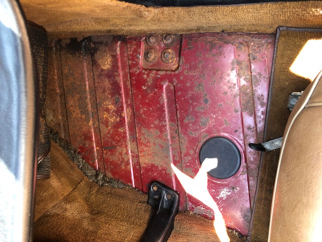

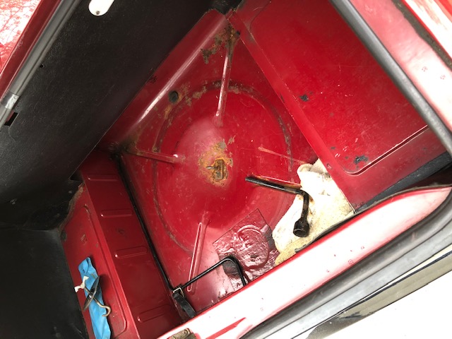

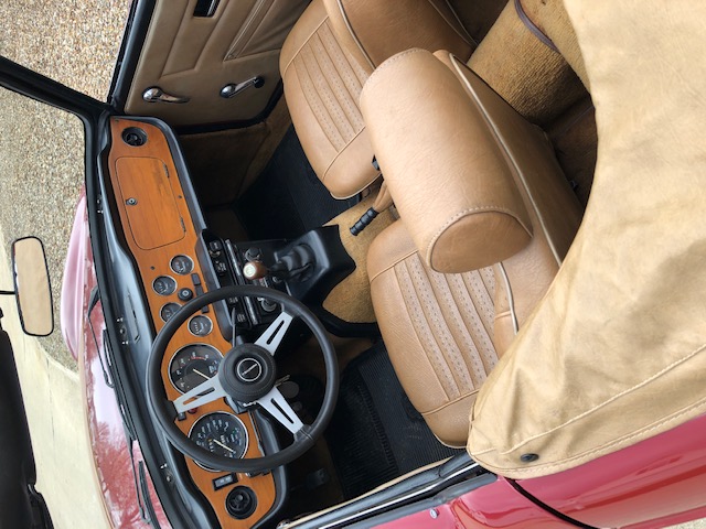

Hey Triumph lovers, I am thinking about maybe buying this TR6. I want you experts to tell me what you think about some rust on the car. The car is several states away from me so I haven't been to look at it in person. They do not have any pictures yet under car so I also haven't seen frame. Let me know what you think.
NutmegCT
Surface rust is common on most older cars, and remember that Standard/Triumph probably never expected them to still be on the road 50 years after manufacture. But those few photos you share don't show the frame, undercarriage, suspension, engine area, etc. We've all seen many of these cars that look good on the outside and interior, but have major corrosion problems not on view.
Be sure to personally inspect the car before buying. Either you, or someone knowledgeable in the area where the car is now.
Been there - done that.
Tom M.
Mickey Richaud
Hey, neighbor -

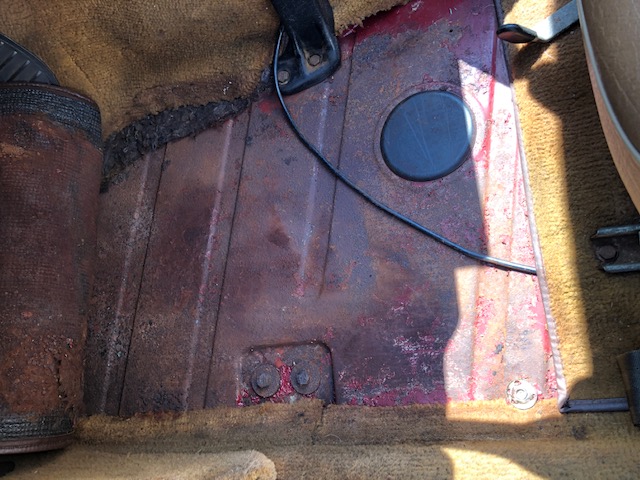

Agree with Tom, but some of that rust looks a bit more advanced than surface rust. One has to wonder what's underneath, especially near critical frame areas.
The car does look good, though!
bammons
Looks like some pinholes in the floor pans. Some people would drive as is or slap some fiberglass on them for now. Floor pans can be replaced later if need be. Not unusual. But as stated above this is not enough to see, you need more info. Bruce

A common rust area is above the rear wheels, where the panel meets the tub. A photo (using a flash) might show damage. (Although it could be hidden by thick undercoating.)

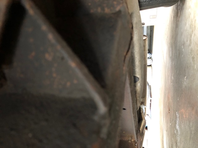

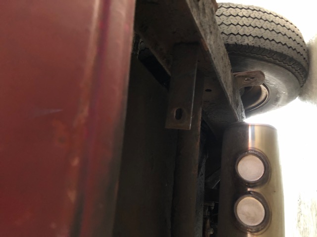

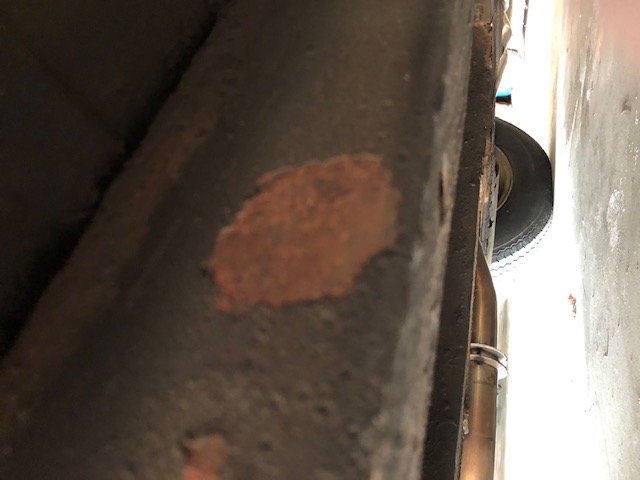

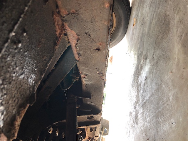

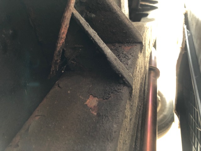

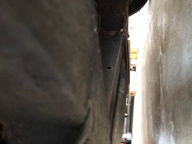

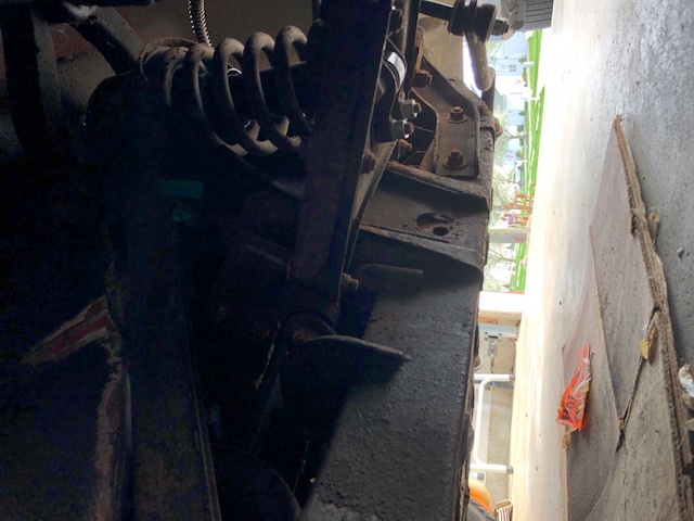

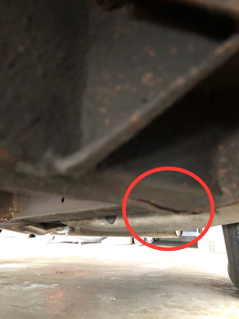

Okay Triumph experts what say you? I got a few underneath pics. I am not sure but I think the owner is an older person like me. He did not have access to a lift so this is all I got.
Gliderman8
These two pics catch my attention. It may not stop me from buying the car but I think it’s wise to have a knowledgeable person investigate these areas. Just my opinion.
Gliderman8
RATCO is your friend if you need a new frame.

Gliderman8
Is the second circle a crack or just some delamination of the chassis coating?
Same answer...have an inspection done.
When I circled the area in the second photo I had a similar thought (that it may be something other than a crack).
That’s why my suggestion (like everyone else) is to have an inspection done. Without one you can’t complain AFTER you bought it.
