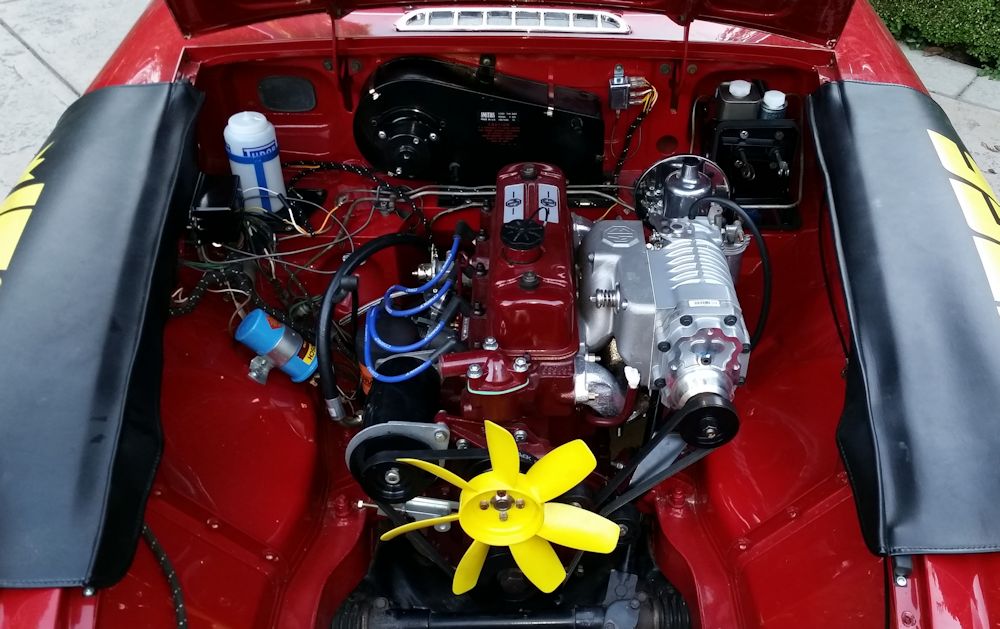

The worst part of the engine bay is done. I must say installing a heater on a mk1 is sooooooo much easier than a later car.

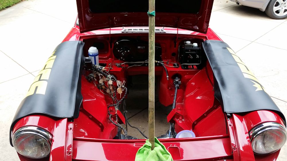

I swear who ever designed the blower kit at moss must of though everyone had a 8 year old at their disposal to get the nut on the left side of the center exhaust port started. It takes twice as long to get that single nut on as it does to install the other 5.
Was just about to finish up with the drive train when I found out the early cars need a longer drive shaft DOH!

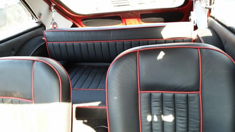

I was "" close to bringing it home today

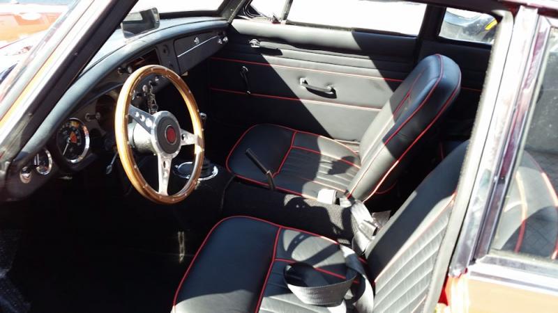

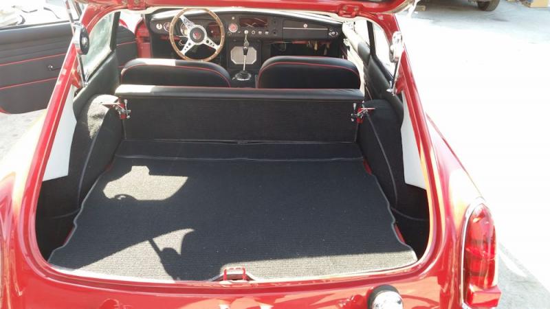

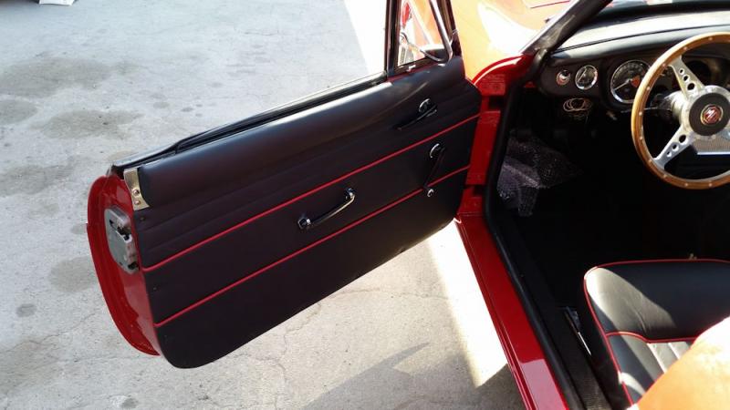

The interior is in and looks pretty good. Seats are all leather carpet is wool. Unfortunately when the panels were put into the tail gate one screw was to long and dimpled the tail gate so it's now back at the body shop to be repaired. At least I got to drive it a bit today.

Mickey Richaud
If that's all you do to it, you're better off than most!
Like the black with red interior - looks sharp!

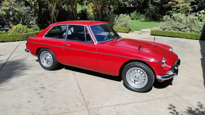

Finally starting to rack up the miles on the car after a month and a half off due to a broken right foot. Car's running pretty nice at 350 miles and the engine feels strong with gobs of torque.
Ran into one issue with the oil pressure relief valve opening up a bit prematurely and found the machine shop left out the shim. I'd rather do a roadster windshield than do that job again. Also caught the lifter cover bolts leaking a bit and swapped out the washer for the later style rubber/cup washer. I also went with a light tint on all the glass to help cut down on the socal sun. Now I just need to rebuild the rear suspension, add a bigger swaybar up front and get the car aligned and it should be set.

That is a pretty car, Stewart. I love those wheels!
All those sorting out details... at least you're making good progress with them.
