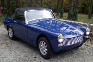

I work at a community college and the automotive department is needing cars to look at brakes and I have an appt set up for them to take a look..... The department chair started his carer on British cars and he is excited to have the car being brought in. I have already told him I have several questions for him. Not sure as to posting pictures, but guess attachments are the easiest to do.
Thanks again.
