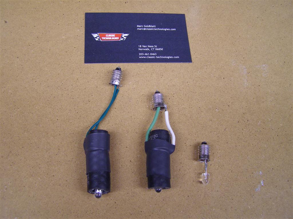

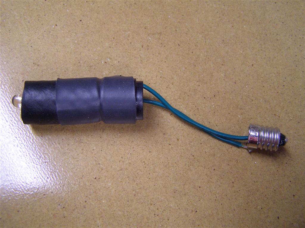

I was able to talk Marc into making a set of these for me and he is now selling them to any LBC owner who has the annoying turn signal cancellation issues. By that I mean where you think that they cancelled and you are driving for a few miles with them on because you are enjoying the sounds of your engine.
These have a beeper built in and are of the design the John Wells (in England) came up with about four years ago. John is no longer interested in making them and gave away the instructions and said he didn't care if anyone used his design, so here they are.

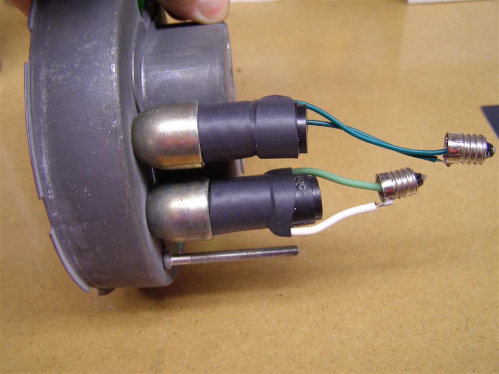

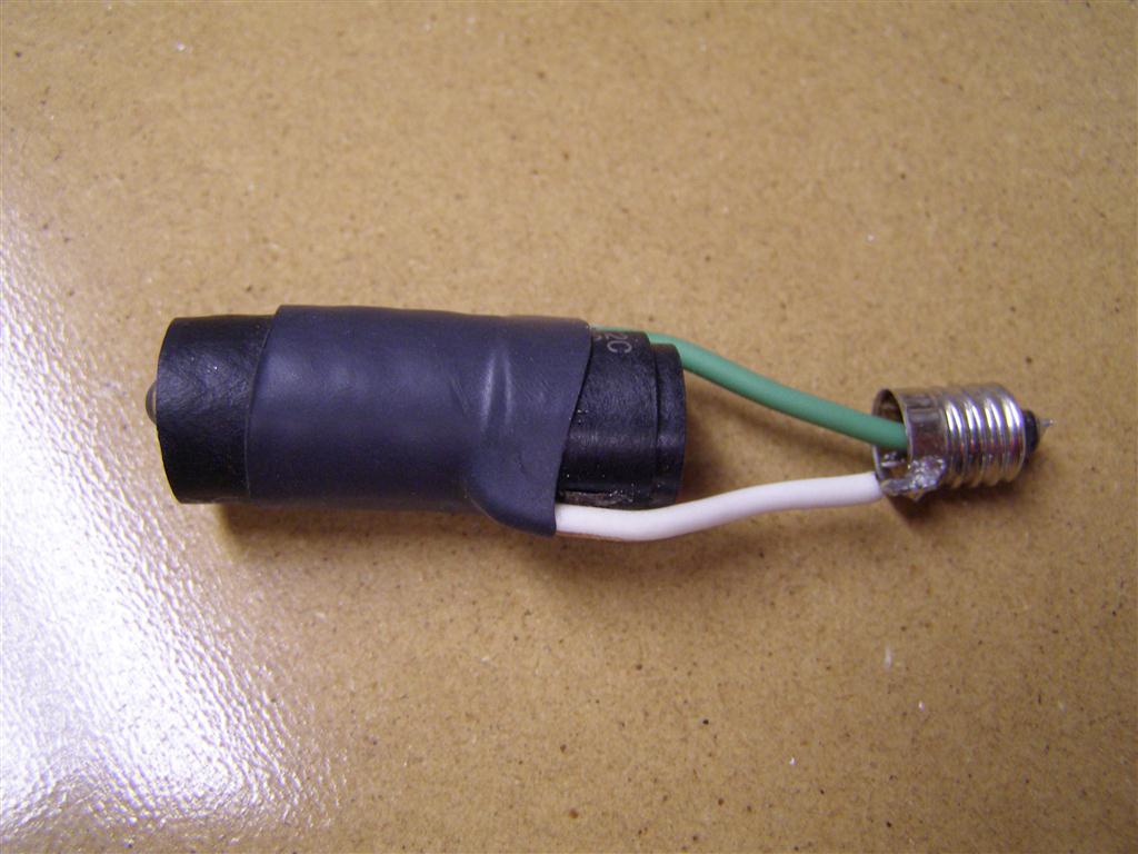

Marc went a bit further and added a different tone to one for the oil pressure that is not as loud as the turn signal unit. You simply reach under the dash, pull out the T/S indicator bulb socket, remove the bulb and screw this one in. You will see how the rubber sleeve slides into the housing after that, from the pictures I took of a spare speedo housing with these set in place. You can buy one or both and please remember.....I HAVE NO FINANCIAL INTEREST IN THIS PROJECT or Marc's company.
If interested, you can order them here:
Classic Techologies Trafficator

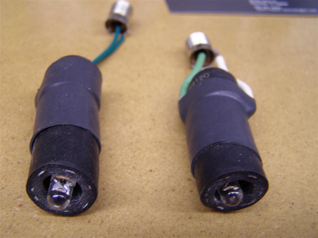

The important feature of Pauls new indicator light accessory, is a high intensity LED along with the chime. The LED really lights up the indicator lens and makes it many times more noticeable. For cars with one indicator light, the polarity changes and you need a voltage rectifier and a bunch of extra electrical components and would need to be an electrical engineer to figure out how to get it all to work. Going to Radio Shack to just get a buzzer, is just going to give a lot of aggravation. They aren't going to have the size, sound, and electrical specs needed to give you something that you would be happy with in the end. Then, running around to buy 1 LED, 1 buzzer, 1 resistor, 1 voltage rectifier, wire, solder?.. Most of these things you cant just buy 1 anyway. Also, figuring out how to modify the bulb to be able to solder to it? The assembly takes time to build, even after everything is figured out. Its not worth the effort to try and do it yourself when it can show up at your door all done for $29.50 (final cost). Unless, you are just up for an electrical challenge.

Hondo, I just checked mine and it works on both sides, equally bright and equally loud.

just put my trafficator in and it is nice and bright, both left and right turn signal lights up and it has a nice medium tone
