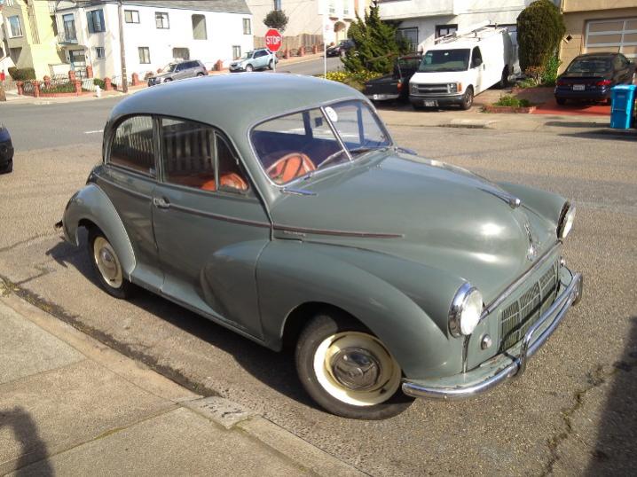

Here's my latest acquisition from earlier this year. This is a '53 Series II, also referred to as a "split-screen" (for obvious reasons). These are quite a bit more rare in the states.
