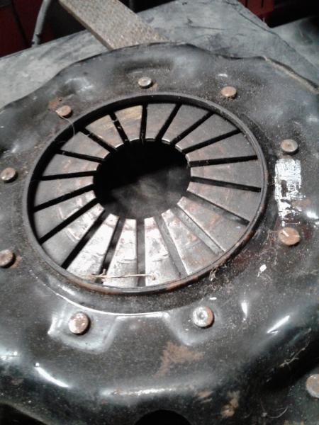

TR6 Looking at clutches and their differences for my 69 TR6
Got_All_4
Looking at the clutches for my rebuild of my 69 TR6 and have noted a difference in design between Luk and Borg & Beck. The Luk clutch cover or pressure plate is designed with straight fingers where the Borg & Beck are raised at the end that kinda forms a boss where the throw out bearing would ride ( I know it actually doesn't touch the fingers until pushed). Over the years there have been so many problems with the TR6 clutches I
just need to know which one is best for my year.

I mentioned the LUK clutch. I put one in my TR250 over 20k miles ago and no problems. Might just stick with LUK. Hopefully I just didn't jinks myself.
Tybalt
One thing I learned the hard way is that if you use a Gunst bearing, you probably want the LUK clutch. I fitted one of those "wonder bearings" when word of the Gunst bearing first started getting around with a new Borg & Beck clutch cover and it never worked correctly. After much exasperation and pulling the transmission yet again, I traded a few e-mails with the (now late) Herr Gunst. He did some playing around with his bearing and a B&B clutch cover and responded back that as I had found, it simply would not work properly with those. He indicated that he had never run into that before as he only used the LUK clutches in his shop, so LUK it was for me as well. I did note that after our little exchanges, he added text to the website and the instructions saying that his bearing would not work with a B&B clutch cover.

That reminds me that somewhere in my research I read that when B&B went to the raised fingers on the clutch cover they started to have issues with TO bearings. What I would like to know now is who makes the TO bearing for Powertune clutches. BPNW says their SACHS clutch kits come with Powertune TO bearings. I'm deciding between the SACHS and the LUK now.
Got_All_4
Got_All_4
Actually nothing. I just found out from a local supplier (he carries them in stock) that it is actually a SACHS clutch. So TRFs price is a bi high if that is actually the case. Also looking at the clutch cover that I took off the 69and is a Laycock. So everyone is saying that LUK and Borg Beck are original so what is correct?
