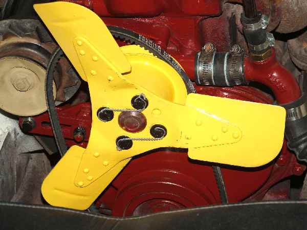

I can't find th' photo of my MGB fan just now but it's been wired with those. :wink:

Found it. Bit of overkill, but hey, I've seen 'em get away and make a radiator into yard art before. :wink:
A nice example of the proper use of lock wire. For those who have not done this, you will notice the application of the wire, with tension on each bolt, in the direction that would tighten the bolt. The real trick is to get just enough of the wire twist to reach the second bolt, then when the wire that passes through the second bolt is twisted, it creates tension on the twisted wire between the two bolts holding them fast. That puppy is going no where.
