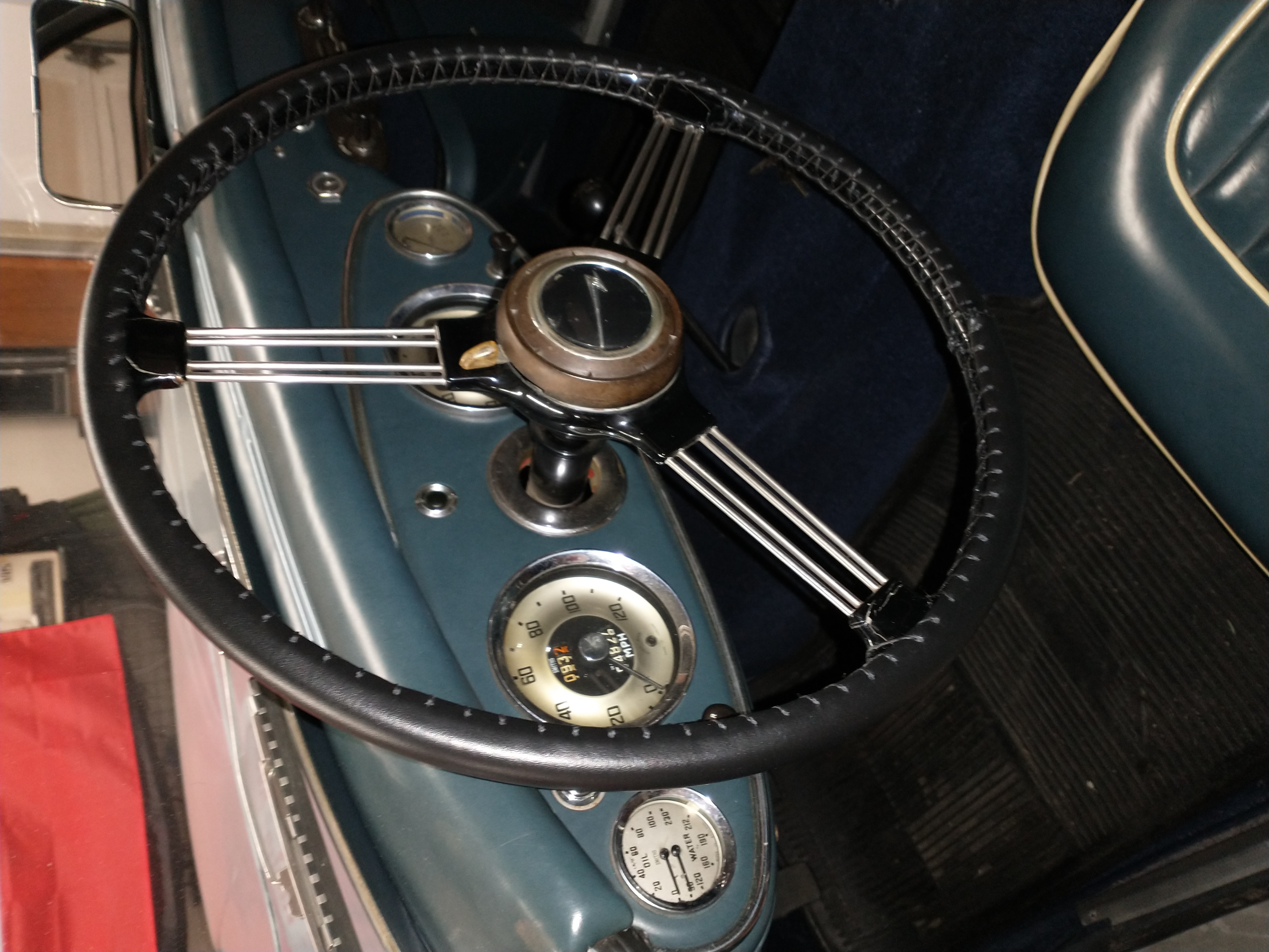

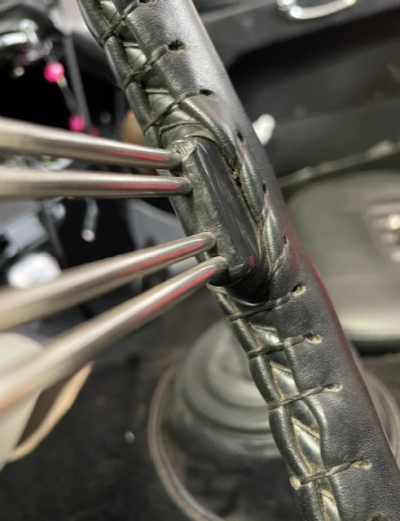

I also installed a Wheelskins (or similar) cover in early 2005. I do not remember what size I bought but when I fit it to the wheel it looked like it may end up being a bit loose. Turned out in the end to be a good thing it was. I wrapped the wheel with black bicycle handlebar tape and that added, perhaps, about an eighth of an inch to the diameter. Rather than the thread that came with the cover I used some black Nylon cord that is used for seatbelt webbing. Ended up with a very nice fit and feel with the added padding. It has held up well over the years. Pictures here were taken a couple days ago. You can see a bit of the handlebar tape in one of them.
