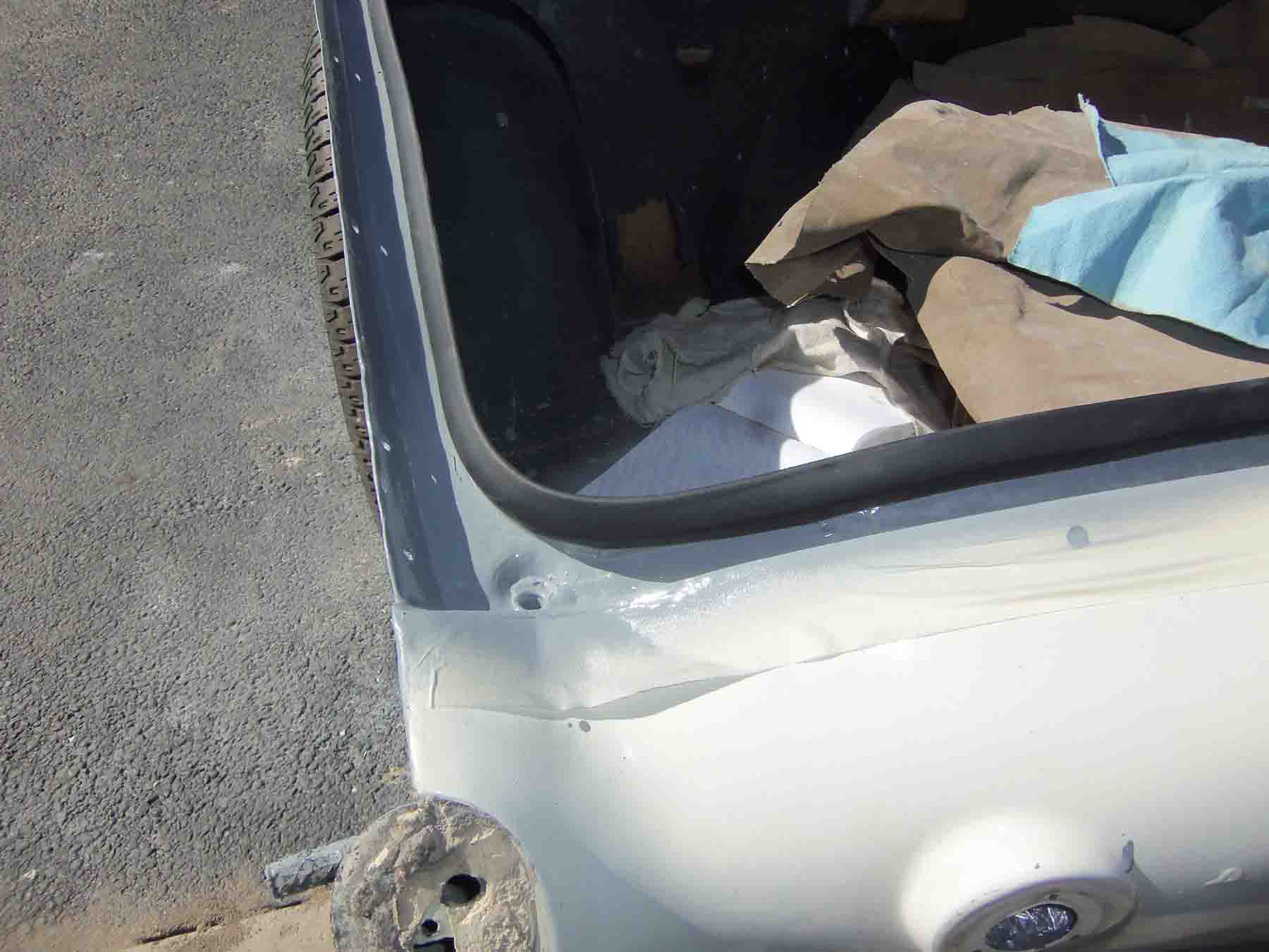

Gust got this from the Roadster Factory (item # 608434) and have been working on the drip edge in he boot and decited to lay in the seal to see where I need to do more work and I was surprised to see this seal in he bag. It's like the TR4 seal on my 250's boot lid. I thought all TR3 seals were glued in along the rail? My is a 60 and TS677...

I guess my question is I'm not sure this is the correct seal. The lip that it slips over is tall and the new seal doesn't look like it fits correctly. The only ones I have ever seen are glued in and looks like the seal on the spare tire cover. Anyone have pics of early and late installed seals? I can't be 100% sure this is the original rear end from my car. There was not a lot to work with on my original inner tube and I had it sent out to be restored and it is possible that they use a better rear clip. Although I've been driving this car for 30+ years it never had the proper trunk seal. Just a seal from another brand of cars that I had laying around.

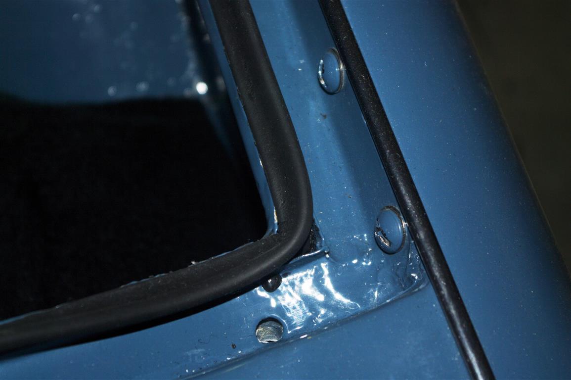

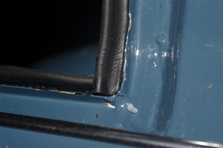

Here are a couple from my early TR3 (56). Seal supplied by TRF. Not great pictures, but hope they help. Cheers, Mike

The seal in the photo looks correct for the late tr3. The other issue is which direction the seal leans. Yours looks correct there also.
charley
Kleykamp
Yep. Looks like my '61. I did not glue mine on, but as stated before, it surely would hurt to glue it. If it has the right amount of "tension" at the corners it should stay in place, but occasionally mine would come loose at the corner. I'd just slip it back over the metal edge. Now that it's been on a while it doesn't move.
CJD
That looks like the correct seal for a 1960. I believe you have it set backwards, though, in the picture. I placed mine so the curvature was outward.
vivdownunder
Some post 60K repro seals won't fit correctly. Often the channel in the seal has to be cut deeper so it can drop down on the raised lip far enough for the trunk lid to close. To glue it down, I run silicone into the deeper channel in the seal, fit it, then lower the trunk lid so it just presses the seal down sufficient for best waterproofing. Allow 24 hrs for the silicone to cure.
Viv
Got_All_4
Got_All_4
Ok thanks all. I will probably put a little weather strip glue on the edge just to add a little insurance it stays put.
