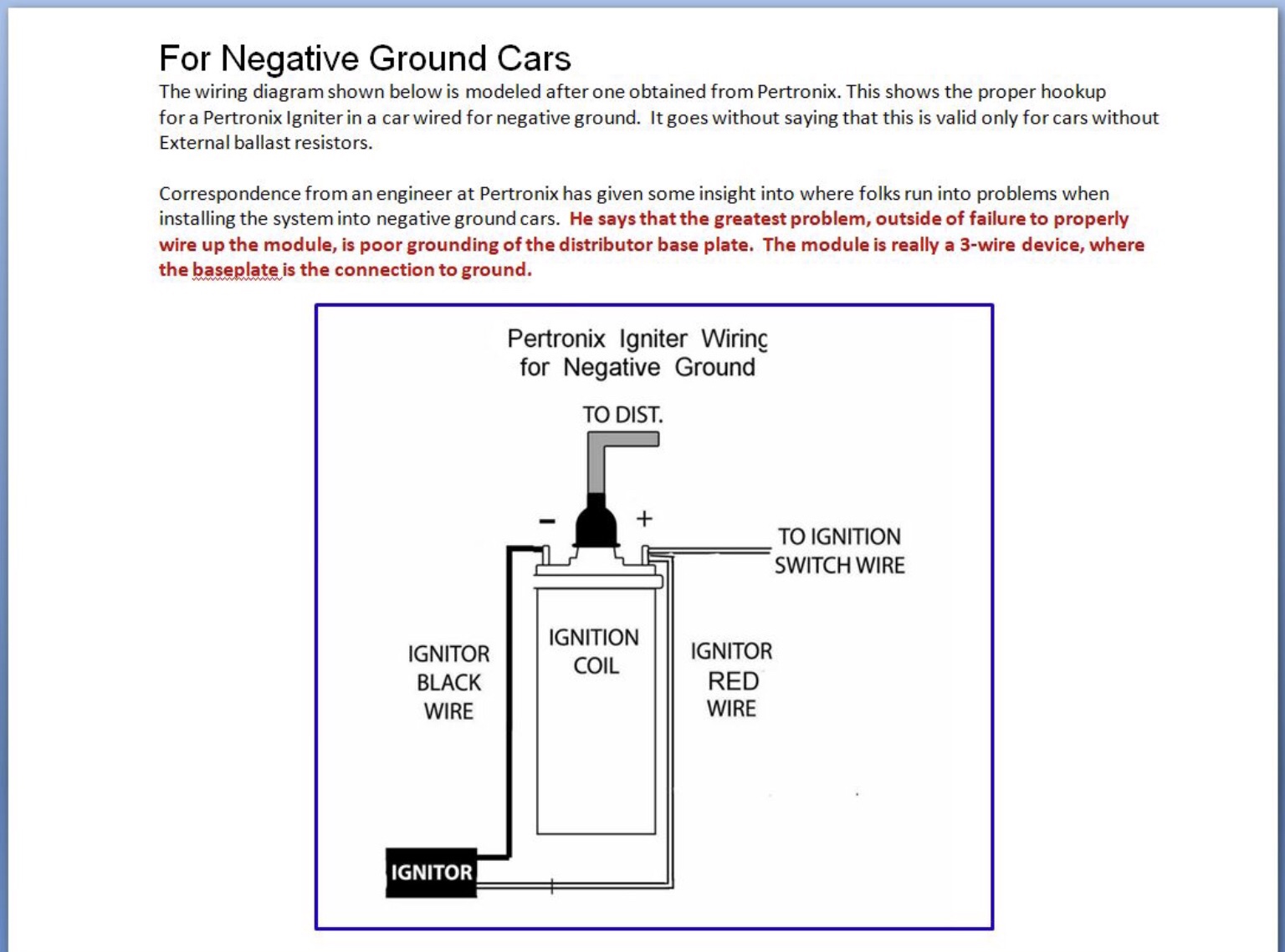

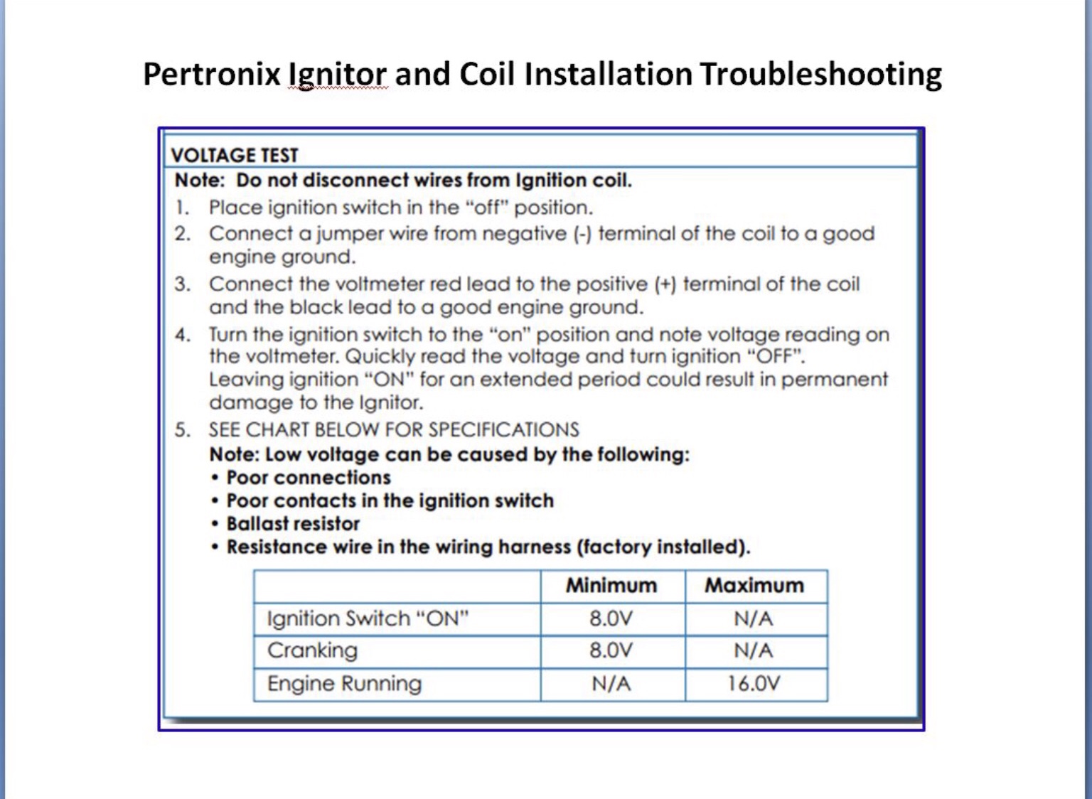

Fix the 180 out of the dizzy first. It’s very easy!Thanks all for your thoughts. I'll be investigating the suggestions. A couple of new details. I installed the original coil and had 8 volts (using my Harbor Freight multimeter) with the key on. The battery checked at 12.4 volts. The car has been idle for two weeks. No spark on the spark plug with either during vigorous cranking. But I had sensed that the engine wanted to start upon turning off the ignition. With a plug grounded on the block, it does not spark on turnover but sparks just once as the ignition is switched off. We--my neighbor has enlisted--tried it a couple of times with the same result. Is this diagnostic? As it happens, I discovered years ago that my distributor is 180 degrees out and have never fixed that. The car is negative ground.
