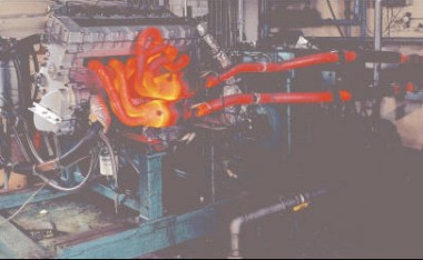

Correct me if I'm wrong. The maximum temperature of your header is seen when the engine is running at high RPM under load. I've seen headers glowing red during tractor pulls and extended load testing. It's hard to say if your header ever glowed red, but it may have reached the critical temperature for the coating to break down.
My guess is the 400 degree temperature you saw was at idle after warmup or after a short drive. The issue may be the application of the wrong coating.
