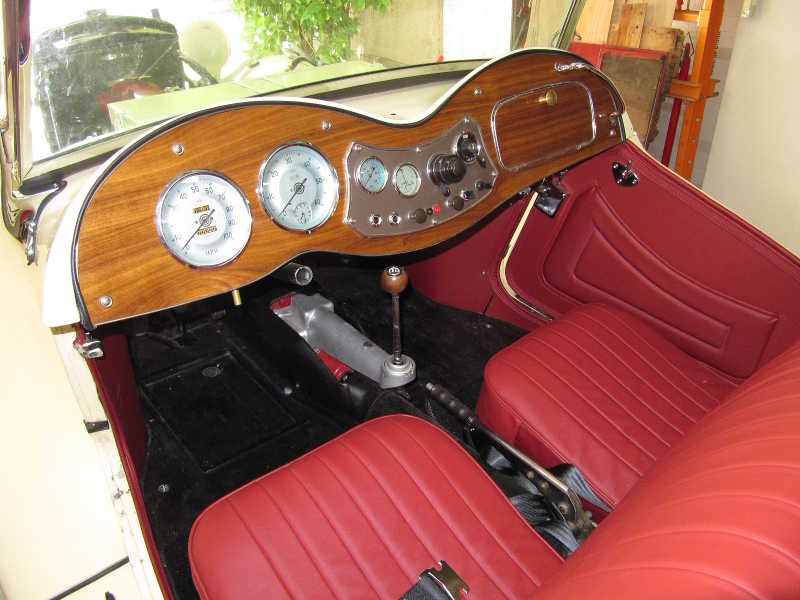

For my MGTD, I used several coats of polyurethane varnish with sanding between coats, progressively finer sandpaper after each coat. Anything like that will give you a really nice finish.
https://www.nonlintec.com/mgtd/interior/#dash

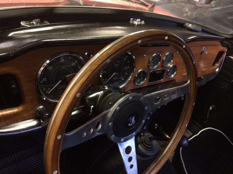

I completely stripped my old delaminating dash and bought a piece of Walnut veneer to re-cover it.
It came out beautiful.

I have that tung oil from realmilkpaint which I use on my mahogany decking cut 50/50 with mineral spirits. I don't get that glossy finish like you have, Whats the trick? multiple applications with sanding increasingly fine grits?
Shoopal,
Actually the dash is more of a semigloss, guess the light caught it just right.
The whole point of an oil finish on wood is not to build up a surface coat, but to allow the oil to penetrate the wood grains. The gloss or lack thereof comes from the rub down of the wood between the oil applications/cure cycles.
The trick is the 50/50 initial applications (so the Tung oil penetrates deeper), with wipe downs after 1 hour or so, (so you don’t build up a surface layer, a big no-no), followed with 24 hour or so cure in between applications.
In between applications the wood is rubbed down to remove the wood “whiskers” using either increasingly finer grits of abrasive paper or my preferred method 0000 steel wool or equivalent.
The final applications are with 100% Tung oil with a 0000 steel wool rub down and a final rag wipe.

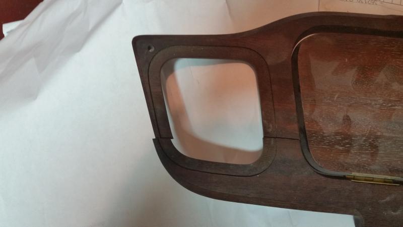

Disaster.When I picked up the dashboard from the body shop, it was broken across the right air duct hole. It takes a bit of force to get the broken pieces to line up so it seems like it shrank up and twisted. Solid mahogany by the way not veneer. I'm going to gorilla glue and clamp it to try to get it together, but I'm really heart broken.
If I have success hiding the split, then I guess I'll finish it otherwise I'll just finish it off (should be good firewood)

I just came back from a cabinet/furniture restorer who will try to glue it back together. They gave me a rundown on finishing options and basically it ran like this:
If you have a dashboard which is a veneer on top of some good plywood backing, then the polyurethane is best for you. My dash is solid mahogany for which the oil treatment is best. The reason is that it will shrink and expand with temperature and humidity and a hard finish will develop cracks.
They advised a 100% tung oil, let it dry, and then a light coat of oil rubbed in with 600 grit. However, I like Merlin's method better.
When I pick it up,I'll go over the routine with him and it varies from what I just said, I will revise the post.
