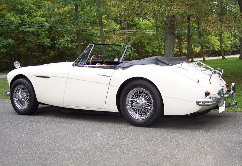

A 165/80-15 tire has a diameter of 25.4 inches. I believe 65 cm is about 25 inches. If that is the height of your wheel arch I would be a little concerned. Here is a pic of my BJ7. It has 165/15 tires on it. I would not want it any lower. Bumps, squirrels and other such road kill. I often think that I will just make sure I avoid road kill, but one day I was motoring down a 2 lane road and I was approaching a road kill right in the middle of my lane. All of a sudden I realized that I could not move out to the other lane because of approaching traffic, I got on the binders and had to come to almost a complete stop with nothing in front of me but the small dead animal, the car behind me almost eat my back end.

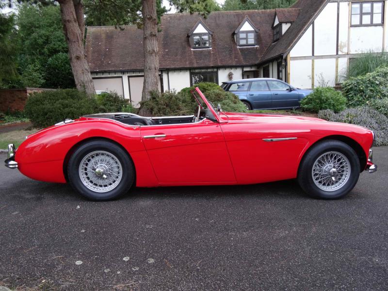

I will attempt to attach a picture of the drivers side (offside) of my car.
I just measured the ground clearance of the chassis. Taken midway along the chassis the lowest dimension, ignoring the centre seam is approx 4in - 3 7/8 in on the offside and approx 4 1/16 in on the nearside. (I note the ground clearance in the workshop manual is 4 5/8in but I don't know if this is under the box section or under the seam.) The clearance under the exhaust box is 3in.
The car looks fine, not obviously low but I am aware that it is lower than what it ideally should be. It rides fine, no bottoming out and no lower than some other I have seen etc. Just a thought that maybe i should consider new springs at some point.

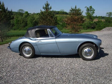

Here's a comparison side view of mine. The rear springs were new and the front was lowered about 19mm. The tires are 195/65-15, with a diameter of ~24.5 " (622mm).

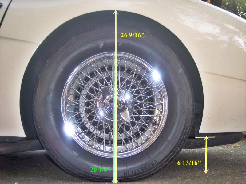

Attached. is a driver's side picture of my BJ8 Phase 1 which incorporates the same rear suspension and frame as your BT7. As tiy cab seem. my measurements were made with 165x15 Vredesteins on wires. However, my original springs were reinforced with an extra second leaf to improve stiffness.
It should also be noted that, due to many operational stresses, left and right side measurements may differ slightly and it is not uncommon to see the left side of a left hand drive Healey standing a little lower then the right. Also, since most outer panels are fitted for best match to adjacent panels, it is very possible that one fender may be slightly higher then its opposite when taking measurements relative to the ground.
From what I have experienced, raising the rear height of a Healey is more a matter of component change rather then adjustment. with the axel above the frame and spring attached below the axel, the common way of adding spacers between axel and spring will lower, rather then lift the body. As a result, the only way to raise body height is to either increase spring tension, raise its front mounting point, or increase tire/wheel diameter. Of these, the easiest is mount new tires with spring replacement coming in second. However, all approaches are limited in the amount of additional height they can apply.
My suggestion, enjoy your Healey now. You will find plenty you will want or need to do soon enough.
Hope this helps,
Ray(64BJ8P1)
