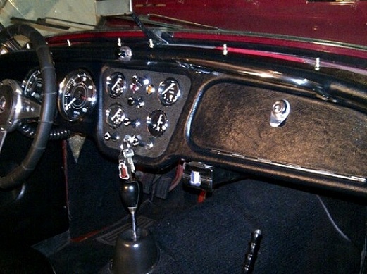

After doing my dash and having my facia restored, I put the heater in. Wasn't easy (all the hoses and bits) so after getting engine bay hose for the left-hand side. I fired it up and let it run for awhile and turned the heater fan on, its medium hot to warm and blows pretty good. I'm happy!
OK Ok It was a little difficult because my hardtop is on but here's how it looks now. A couple of things of notice are the coiled spring wire for my horn (rack and Pinion) and the polished aluimium tab to help open the glovebox.

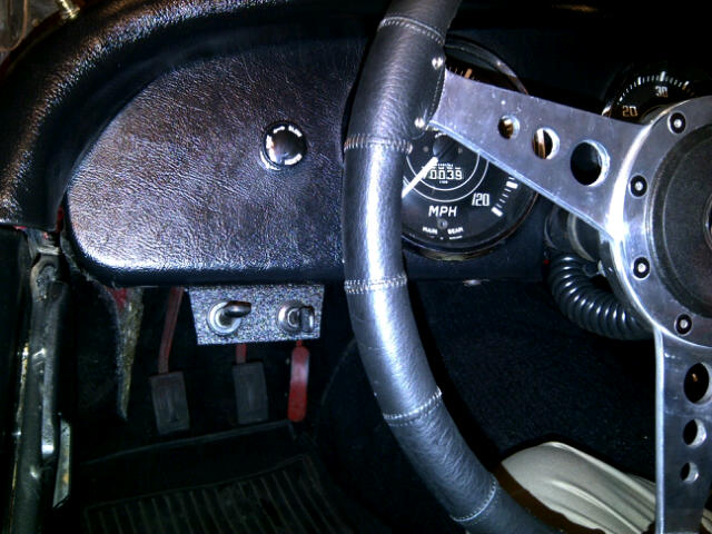

One other thing I did was fabricate an auxilliary switch panel for my driving light and fog light as well as my turn signals and then finished in crinkle paint.
I did the same thing with the horn wire on my TR3 as shown in this thread.
For the directionals, I bit the bullet and installed the MGA switch with the canceling timer in it.
