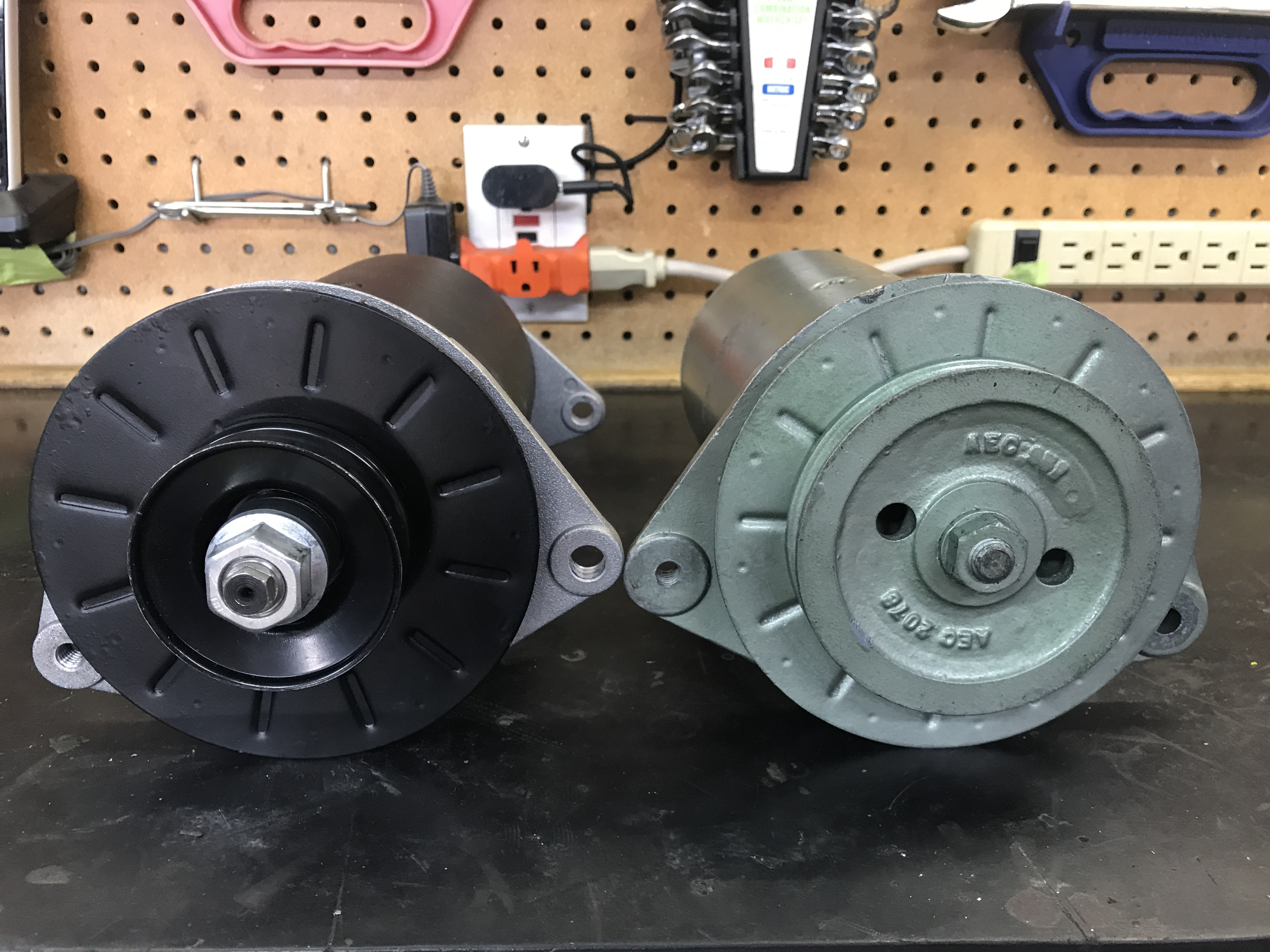

Hello,
I'm replacing the Lucas C42 generator with a WOSP LMDC42 alternator, Dynator.
The pulley on the WOSP has a smaller diameter than the Lucas.
1) Does the diameter make a difference? Should I swap or ok to leave the smaller WOSP?
2) If I should swap, how do I remove remove the nuts.
The Lucas has one nut.

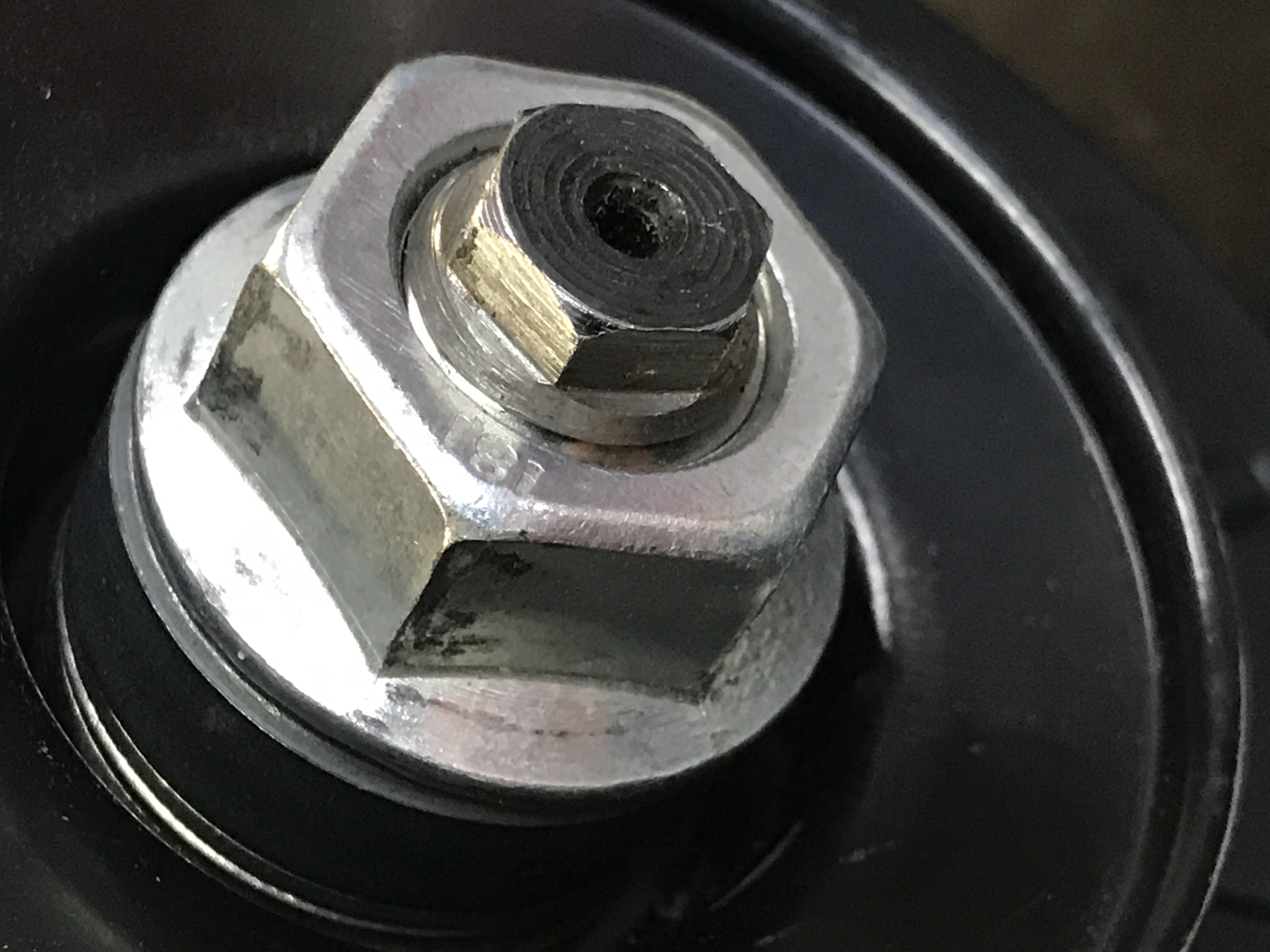

The WOSP seems to have 2 nuts. A smaller one in the center of the larger one. Not sure if the small center nut needs to be removed or why it's there. How do I remove one or both to get the pulley off?

I'd check with the supplier before messing with the pulley. I would be surprised if WOSP sent an alternator with the wrong pulley.
Most alternators run quite a bit faster than generators so usually have smaller diameter pulleys and, from your second picture, it looks like the armature shaft is bigger diameter than the old generator armature shaft so the pulleys probably won't interchange anyway.
The alternator doesn't look like it has two nuts - looks like a hex has been cut into the end of the armature as a way to hold it from turning when tightening or loosening the nut. On the generator, there are two holes in the pully for a spanner wrench to keep it from turning.

Looks to me as if the axle has a (fixed) hexagon to hold when removing the bigger nut

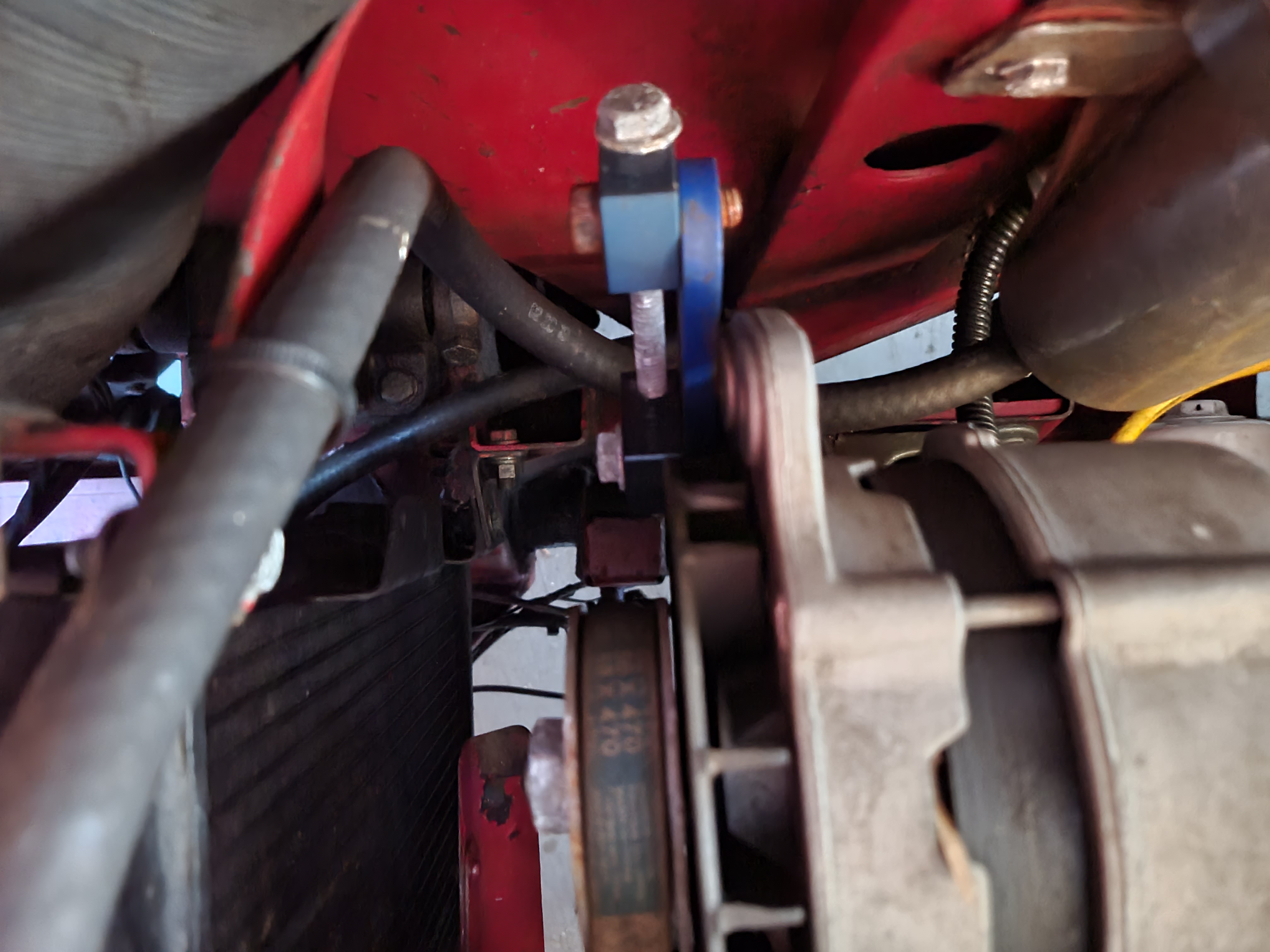

After dicking around with a cobbled-together melange of slotted arms and wedging big screwdrivers against fragile British castings while trying to get my big mitts into tight places I decided to install this universal Balmar tensioner:
Life is now good--no bruised arms, etc.

The initial installation takes a little time setting up distances, pivot points, etc. but once installed tightening/loosening the belt is simply a matter of backing off a lock nut and turning a wrench. It comes in blue anodized but if that bothered you it could of course be painted Healey Engine Green or the color of your choosing.

It's hard to get a shot that shows much without major disassembly but attached is a pic taken from directly above the alternator. The anodized blue piece is the bracket and the nut is the adjuster. As said, the initial mounting of the adjuster and the alternator is a knuckle skinner but once it's in making an adjustment on belt tension is a piece of cake.
