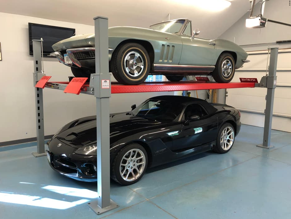

All depends on how much you want to spend and how much room you have . If you have the height and the money go for a four post drive on lift with bridgejack . Great for oil changes , brake jobs , cleaning without bending , etc etc . Also doubles for storage in winter .With a chunk of aluminum beam across the ramps and a chain block it becomes an engine hoist as well .
other option is Quick Jack .
I have a four post drive on …..best tool I ever bought .
Just to add , I rarely walk around in my shop , smooth floor , old wheeled office chair . Car on the lift at appropriate height and just scoot around from car to tool chest to workbench etc . A TV, good stereo and a fridge also help the days go by in my “office”

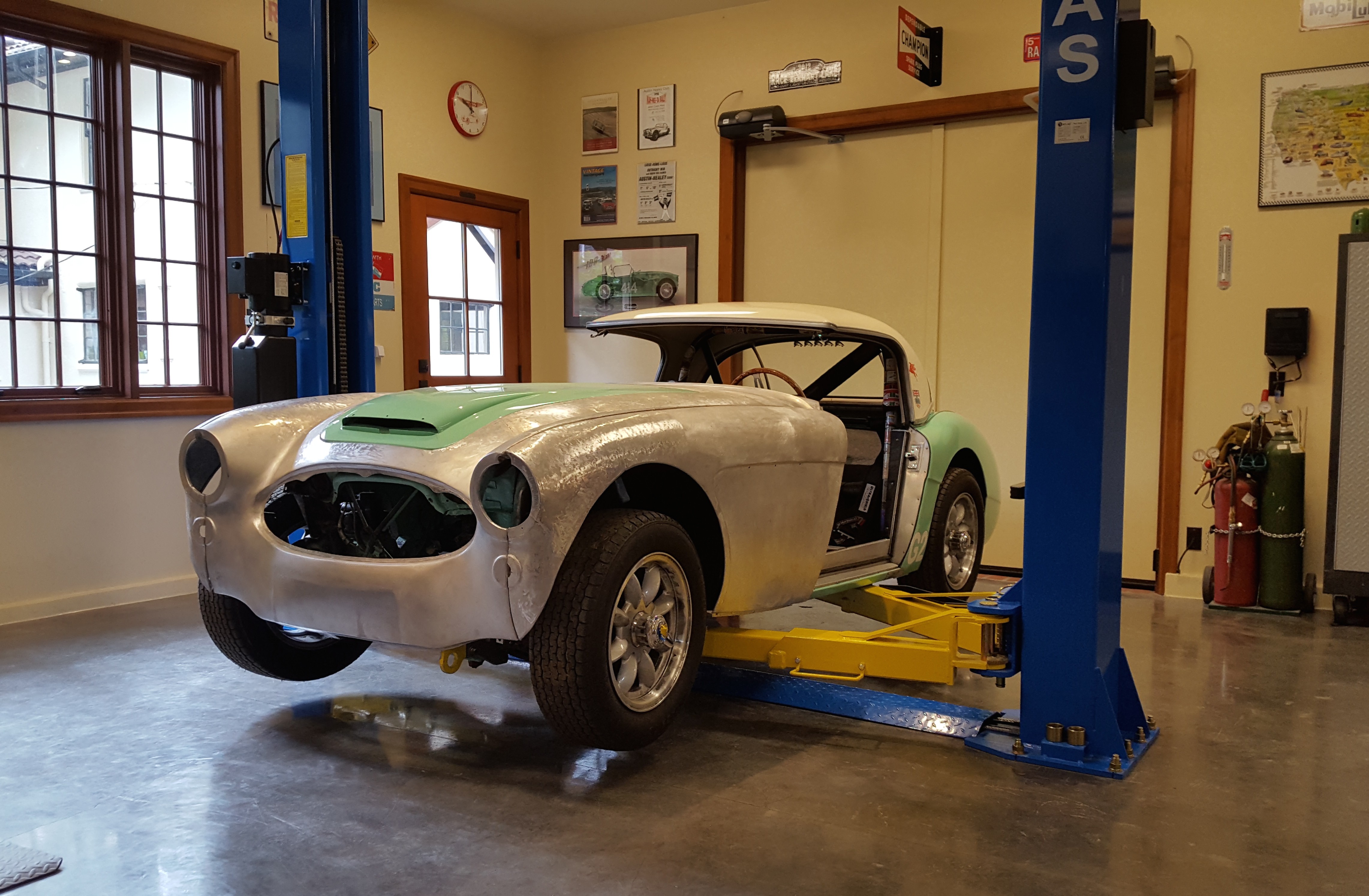

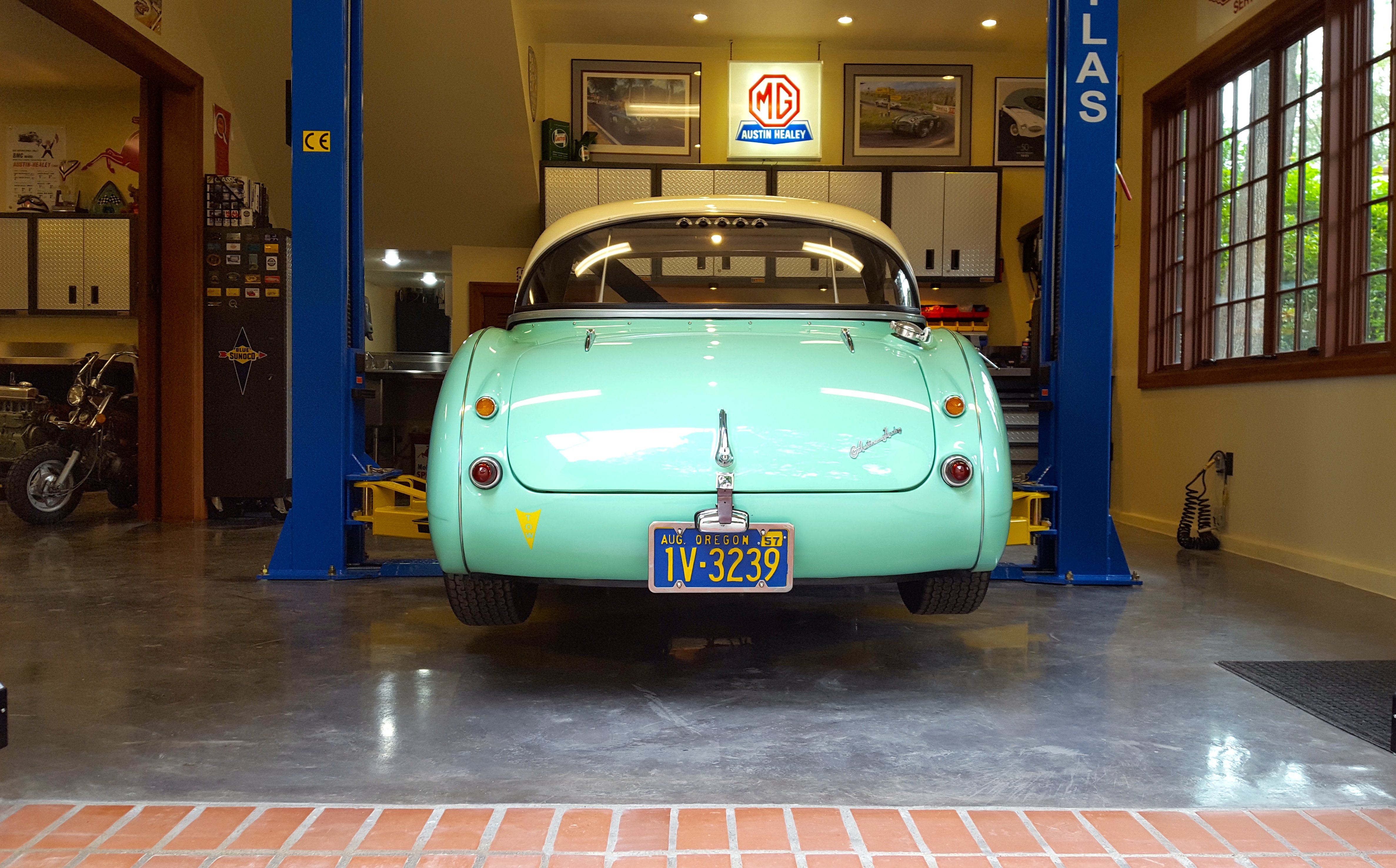

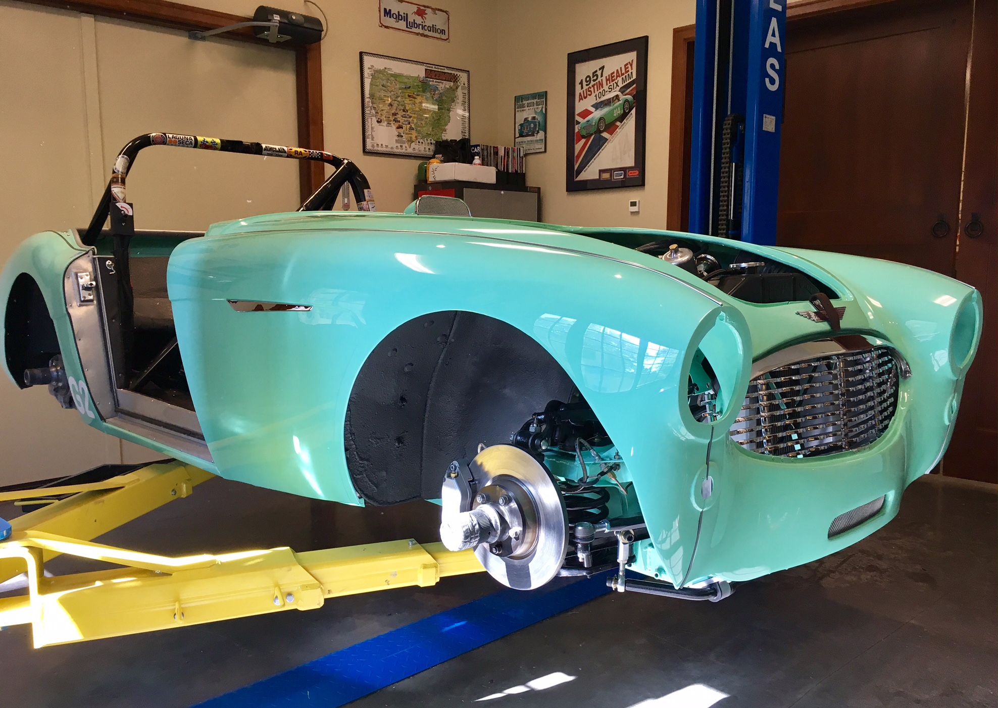

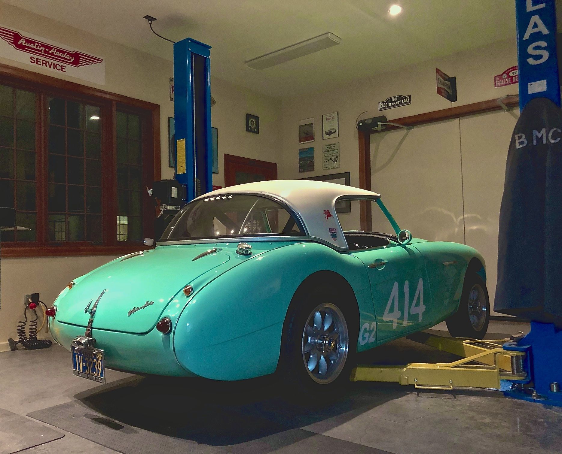

Four post lifts are fine if you're just need to store more cars. To do any real car maintenance a two post system is the best. I've own both, with the amount of pre and post race work I do on # 414 a four post would be ridiculous. If your plan is to park the car go four post, if you like to work on your car and would enjoy the addition space in your garage go two post and be free of the cumbersome dimensionally challenged four post.

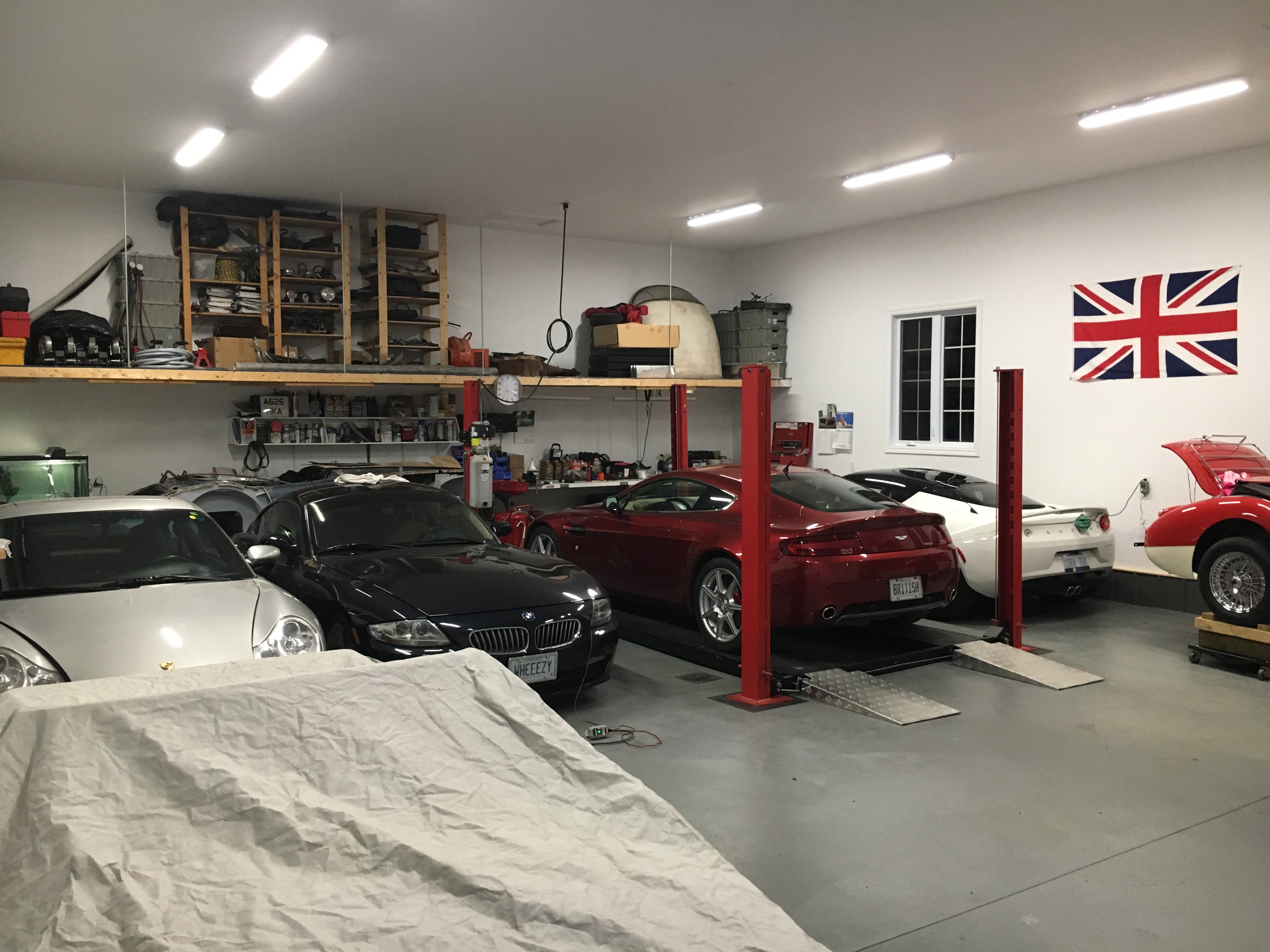

I was just going to chirp in with similar comments to Dougie. I have a Danmar 10k , 2 post lift which gives much more versitality than a 4 post. I almost was persuaded that the 4 post was the better way to go because of the ease of driving on but the ease of doing all sorts of repairs convinced me that the 2 post was the better way to go. But then the big kicker for me was when I realized that the 4 post system cost almost twice as much.
You don’t have to have 10ft plus ceilings to fit a four post lift . The lower ceilings just make it less useful .
The lift in my pic used to be at my old house where the ceiling was only 9 1/2ft I had to modify the garage door tracks so the door was close to the ceiling as possible and had to install a direct drive garage door opener .A direct drive opener with the elevated tracks to get the door way up out of the way is a must . It clears the ceiling area of the clutter of the regular garage door opener and tracks .
I could park her Z4 on top with the Vantage below , it was a squeeze but doable .
No such problems in my new shop 13ft ceilings 👌👍
A two post lift will give you more working room if your only using it to work on but personally I wouldn’t use it to store a car with all the suspension components left hanging while the car is up .

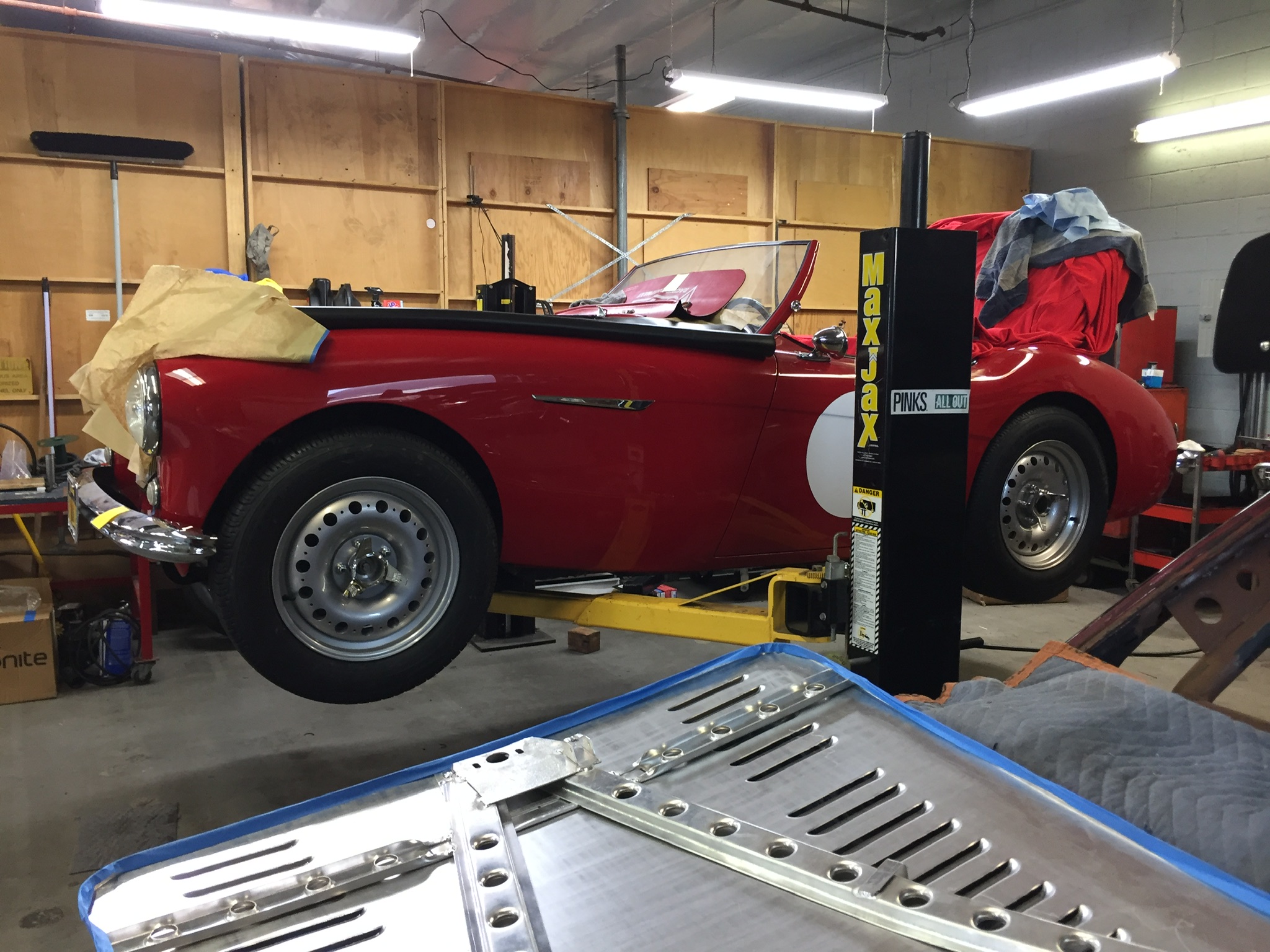

Not having ceiling height for a standard lift and not wanting to permanently tie up a garage bay permanently, I settled on a MaxJax. The almost 4' lift height makes it possible to work underneath from a mechanic's stool, and when the lift is not in use it can be unbolted from the floor and stored against the wall. Installing an additional set of anchors gives you the flexibility to use it for various size vehicles. I find it to be perfect for a hobbyist level mechanic.
The photo shows the maximum working height.
Guido36, I just found out about MaxJax last night and was looking on their website. They say it goes up to 48" lift height. Your photo looks lower than that, with plenty of headroom. Is it an optical illusion? Was the car 4 feet high?
Pretty sure that photo shows the car at the intermediate lift height. Using the 4" extensions that come with the Maxjax the bottom of the chassis is about 4' above the floor at maximum lift.
I am pretty sure that photo is at maximum height but optical illusion/perspective may give a false impression. The underside of the Healey is below chest height for a 6 ft person - about stomach level. The extenders on the swing beams do not fit under the Healey unless you jack the car up first and lower it onto the swing beams with the extenders fitted. Even without them it is very close on clearance to get the swing beams under the chassis rails. I’ll take some better photos on my next visit to the car. Cheers, Guy
