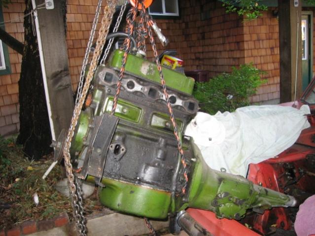

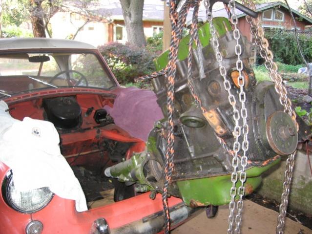

I have used the factory locations a couple of times, but after testing a recommendation from a friend now I prefer just a couple of slings (harbor freight, 5-6 ft length?) straddling the rear and front of the engine. No chance of them slipping with the gearbox and front engine plate, and a nice gentle way to pull.
I had to throw away a block with cracks and both front and back stud locations, I think from some pulling by the studs with the head off. Don't do that!
I've always used truckers rope from Ace hardware around the rear of the engine, and front of the engine and a chain fall--have to judge just how tight
to tie the knot so that the "angle" is correct--

Harold, I can't open your thumbnails for an enlarged view. I remember that I had to really tilt the engine/tranny to get them out and am concerned about the slings moving or sipping.
Engine lifting straps..create a sling.
Cheers
Tush
the front sling goes through or around the front engine mounts (each engine is different of course)--rear sling goes between the rear engine plate,
and the engine oil pan---I've lifted engines out with the tranny attached, and also with the tranny still in the car--supported by a sling rope under
the front--(the heavy part of the engine) attached to something!!!---overall--it's probably easier to remove the engine with the tranny attached--
Then after rebuilding both--it's easier to put them back together--like I said---judging the angle is the main issue--
