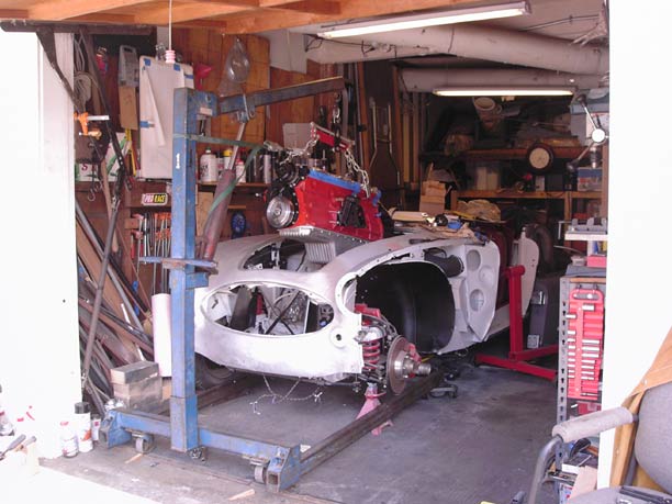

I used option #2. My garage is very pretty small and the drive way slopes sharply down to the street. Once the engine was elevated, I straped it to the hoistarm to keep it from swinging too much (see green strap in photo). This photo was the motor going back in, but as the manual says a lot "assembly is reverse of step one".

thank you for posting a picture. Your garage looks nearly my "big" :laugh: german standardgarage.

Do you take the engine out with mounted zylinderhead? Because if I zoom your picture I can`t see exactly what the the blue one is. The head or the manifold ?

"Not off Hand" simple means I don't really know. The blue you see in the picture is tape. The picture is actually a shot of the engine going in to the car. But it was removed the same way, without the cylinder head or transmission.
