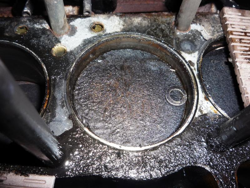

#3 cylinder has been giving low compression numbers in the TR6 that I recently started to rebuild. Using compressed air in the spark plug hole the best guess it was a bad valve. Today I removed the head and I couldn't believe my eyes when I saw this 3/8" lock washer laying on top of the piston. Are any of you missing one?
For the life of me I have no idea how it could have gotten there. I will of course inspect the cylinder walls and the piston, but I think I am lucky from a quick look-see.
If it's yours, just let me know and you can pick it up.

Elliot, Boy did that sucker bounce, all the way to Pa., wonder what happened to the other one. Really ugly looking block. Had to have a blow head gasket.

I'll get it cleaned up and expect to replace the head.
Come get your washer Wayne.

Thanks, if it was only that easy. Wish I could come and help, been a while since I did a TR6. Cleanliness is next to Godliness when working on a motor.

I'd sure like to know how the heck the lock washer got in there in the first place.
Not to worry, I am anal with cleaning things up to reinstall.

Was this engine running, as I would have expected that to make a racket bouncing around in there?

I expected to see a lot of peen marks on top of the piston. If when you found it the washer wasn't bonded to the piston by oil/gas/carbon residue... maybe it fell in as you were lifting the head off.

I agree, would expect some FOD -- not even sure a 3/8 lockwasher will fit through a spark plug hole (the usual way for introducing hardware bits into the cylinders).
BTW -- that is one funky looking block.

Scott- the car sat for 9 years. I just got it running and it started making this clanking noise. I shut it down immediately.
Doug- no way that washer fell in when I took the head off. It appears it's been there some time. The noise and the low compression was the reason I removed the head in the first place.

Update: I flipped the head over, reinstalled the plug in cylinder #3 and covered the valves with diesel fuel. After a few mins, the fuel started leaking out of the intake port. I would say that is the cause of the low compression in cylinder #3.
