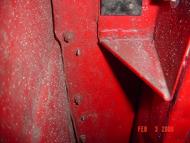

Hi Keoke,
My BN2 rear wheel well seems to be fairly clean at the bottom. Not much place to collect anything that couldn't be easily hosed out. There is a triangular bracket near the top, see attached pic, but it doesn't seem to trap much either. Hasn't been washed out for a while. The BJ8 must be different?
D

John Loftus
Hi Dave,
The attached shows the triangle brace and sill extension that Keoke is talking about. The triangle sits very close to fender sheetmetal and crud/water can find it's way between the two surfaces. Combine the design with very little paint from the factory and you have the reason that original, rust free doglegs are hard to find. My BJ7 was almost rust free but this area needed rework. Hoping that well painted metal and frequent washings will help this area last a long time.
Cheers,
John

Thanks for the piccy John. The problem is when the fender is installed there is a void underneath the extension that holds the dirt and moisture in the dog leg. Your Piccy was taken up too high Dave, that one is the lock plate stiffener.---Keoke

[ QUOTE ]
[/ QUOTE ]
No plates down below on this BN2. The part shown by Kilmartin as "Gusset, shut pillar triangle" looks like it never had been there. A prior owner may have removed it somewhere along the way. Didn't realize the gussets were missing. Good thing it's not a concours car. Not that I would put the parts back anyway.
