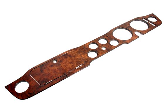

1. Do they convert them to right hand drive?
2. If so, besides switching the steering rack, what do they do about the dashboard? The instruments will be on the left and the glovebox in front of the driver.

Getting a right-hand drive dash is no problem at all. Rimmer Brothers sells them as I'm sure others as well

I figured as much.
