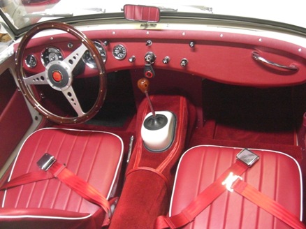

I bought a set of "Flaming Red" belts from Seatbeltsplus.com, their # 1800-60. The color matches my seats well.
The normal place to mount is through the floor on the outside bolts, and through the tunnel on the inside ones. I had to use shorter bolts in the tunnel as they would hit the driveshaft. I could have installed them from the inside of the tunnel to the passenger compartment, but I did not like the look. As a transportation engineer, I should have put in three point belts, but I figure if I get hit in the BE, I will probably be DOI.

I bought the same ones from Moss. Moss offers short and long versions. The short ones are more than long enough. I mounted both of mine in floor, in the rearmost corners of the floor well. The washers they send are about 3" in diameter, Make sure you drill where they will fit flush to the bottom of the car.

I bought the flaming red 3 point with chrome aircraft hardware for my MK2 Sprite.
They look good on my black seats with the red piping.
Red car, black interior with red piping - it really stands out.
The belts work great and are comfortable and look like they fit the car.
